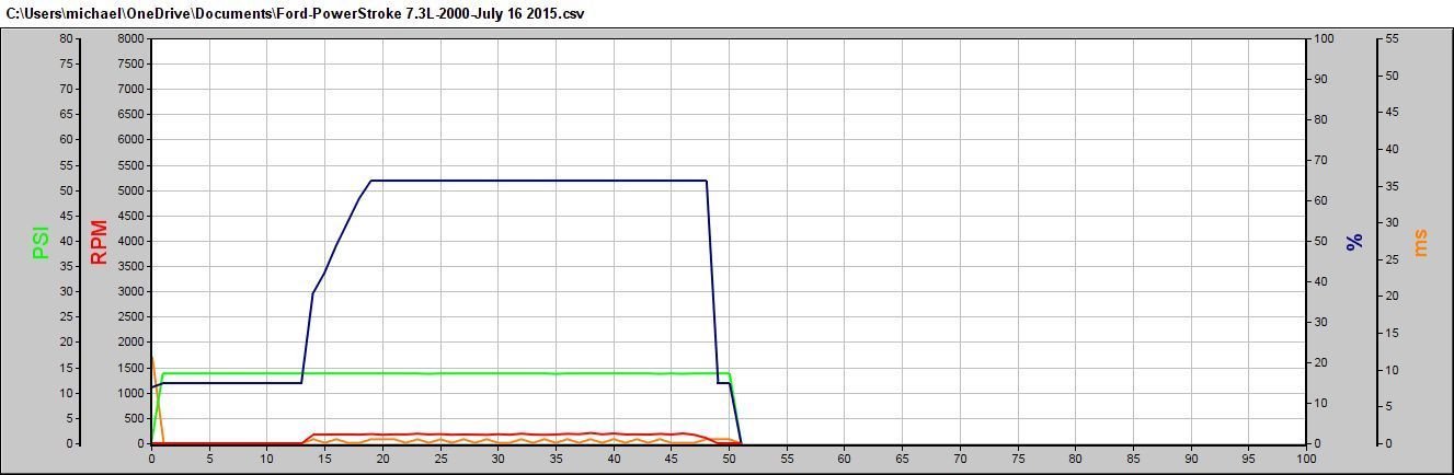

Here is where I am at after a stall out the other day.....now I have a NO START situation.
Truck began to lose power, no response at throttle, began to shake a little without knocking, then just shut down while in traffic....luckily I was moving enough to coast off the road and the girlfriend had her AAA card for a tow to my brothers yard, as I was 50 miles from home.......
Codes before trying anything...................
1280
1209
1211
1212
Running stock, no tuner.......
Disconnected the ICP..............NO START
Replaced ICP with known good spare.............NO START
Replaced IPR with known good spare...........NO START
Replaced FPR poppet sleeve because it looked like it needed it..............NO START
Checked FUEL filter (new two weeks ago)..............Looks like new, not black
Degas bottle has nothing but green liquid in it, looks good.
Oil level good(changed 500 miles ago with correct oil)
Oil in LPR is where it should be
CLEARED CODES and tried cranking.............NO START
NEW CODE.......1212 ICP LOWER THAN DESIRED
BUZZ test............PASS
CODY TEST..........PASS
KOEO test............shows EBP code, but that has been there for a couple of years, deleted that a long time ago
Here are the cranking results for two days.......I am thinking my HPOP did give away....
Old Jul 17, 2015 | 03:21 PM

Include ICP voltage in a cranking log. If there is a low ICP condition while cranking, the PCM will ignore the sensor after a certain amount of time and it will use *and report* an inferred pressure based on other known engine sensor parameters.
