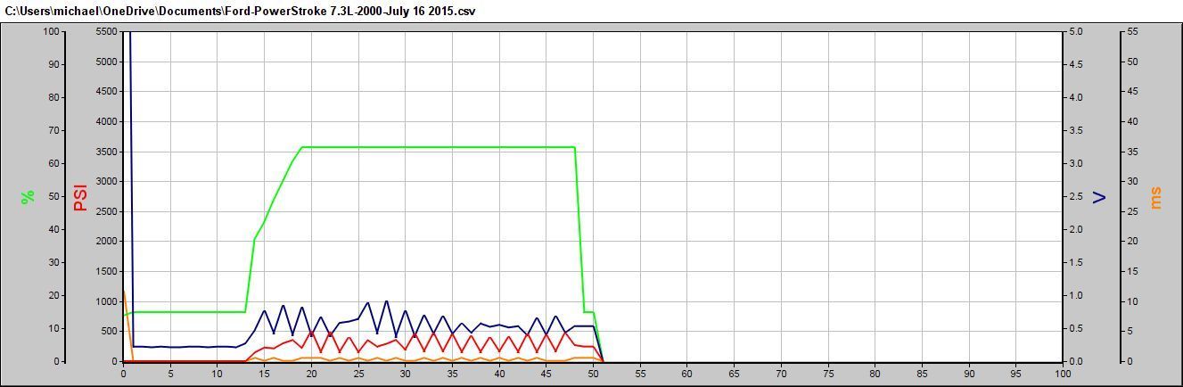

ICP voltage is in the first graph dated the 17th, it is the blue line.
Here it is, included in the graph from the 16th as well.....its about the same......

Lol, I looked at that blue line and then the legends and thought it was a > sign. Derped out on that one, I guess. Yeah, that pretty much confirms low pressure, but it's a process of elimination to isolate the cause. If you can deadhead the pump with the icp sensor or a mechanical gauge in the end of one of the hydraulic lines it would tell you if the pump is toast.
