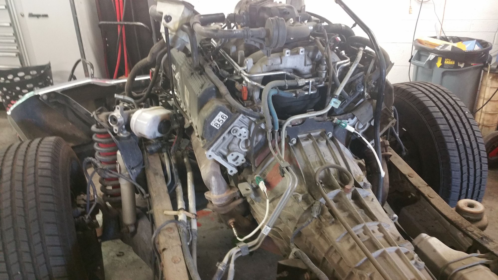

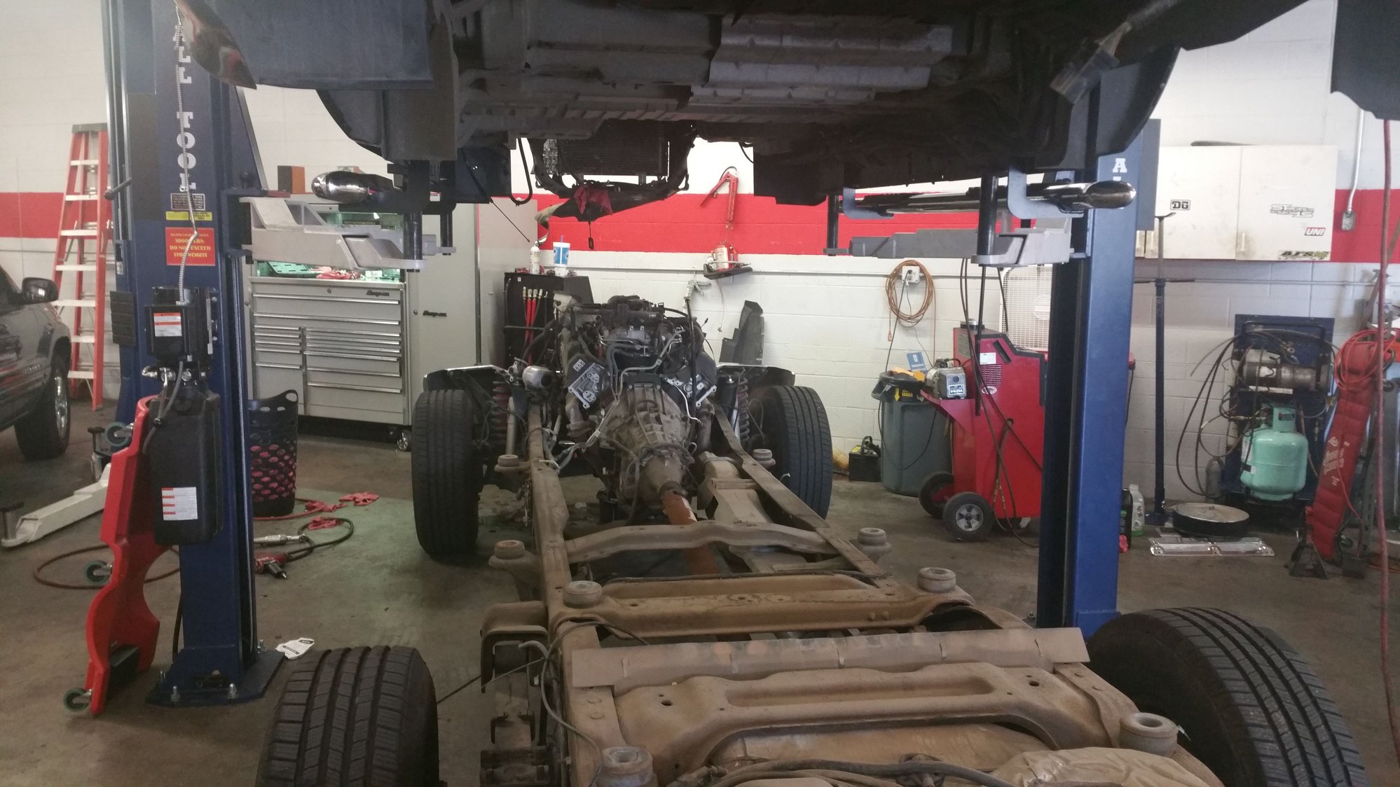

Well heads are off and at the machine shop. I ended up having a friends shop do it. Just time, stress and my back were worth it.
Bottom end looks perfect. Very little carbon, still crosshatched, no lip on bore, and definitely some work out gaskets along the way on intake and heads. A few exhaust studs broke off, but no leaks there.
Here is some pictures.
