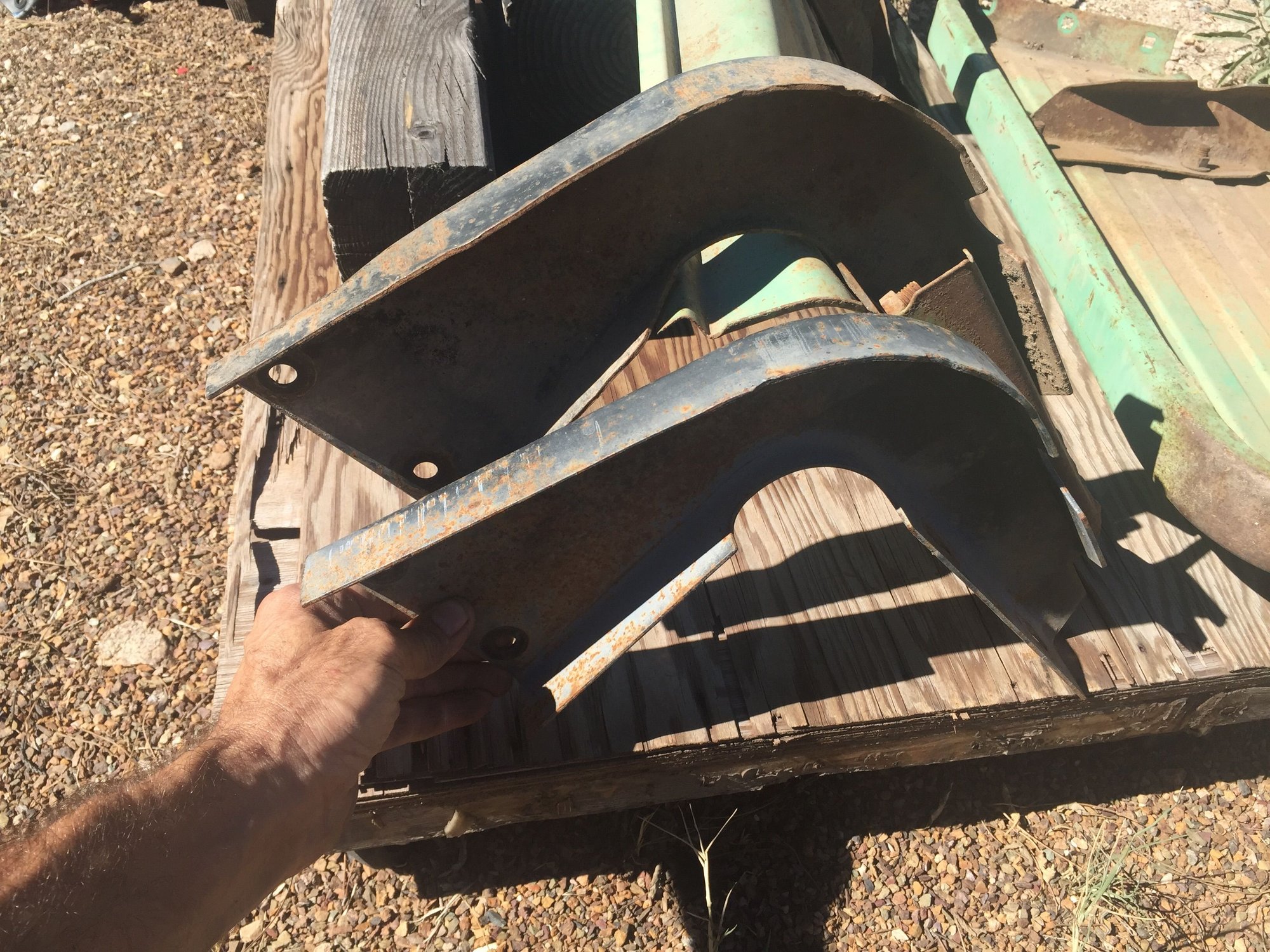

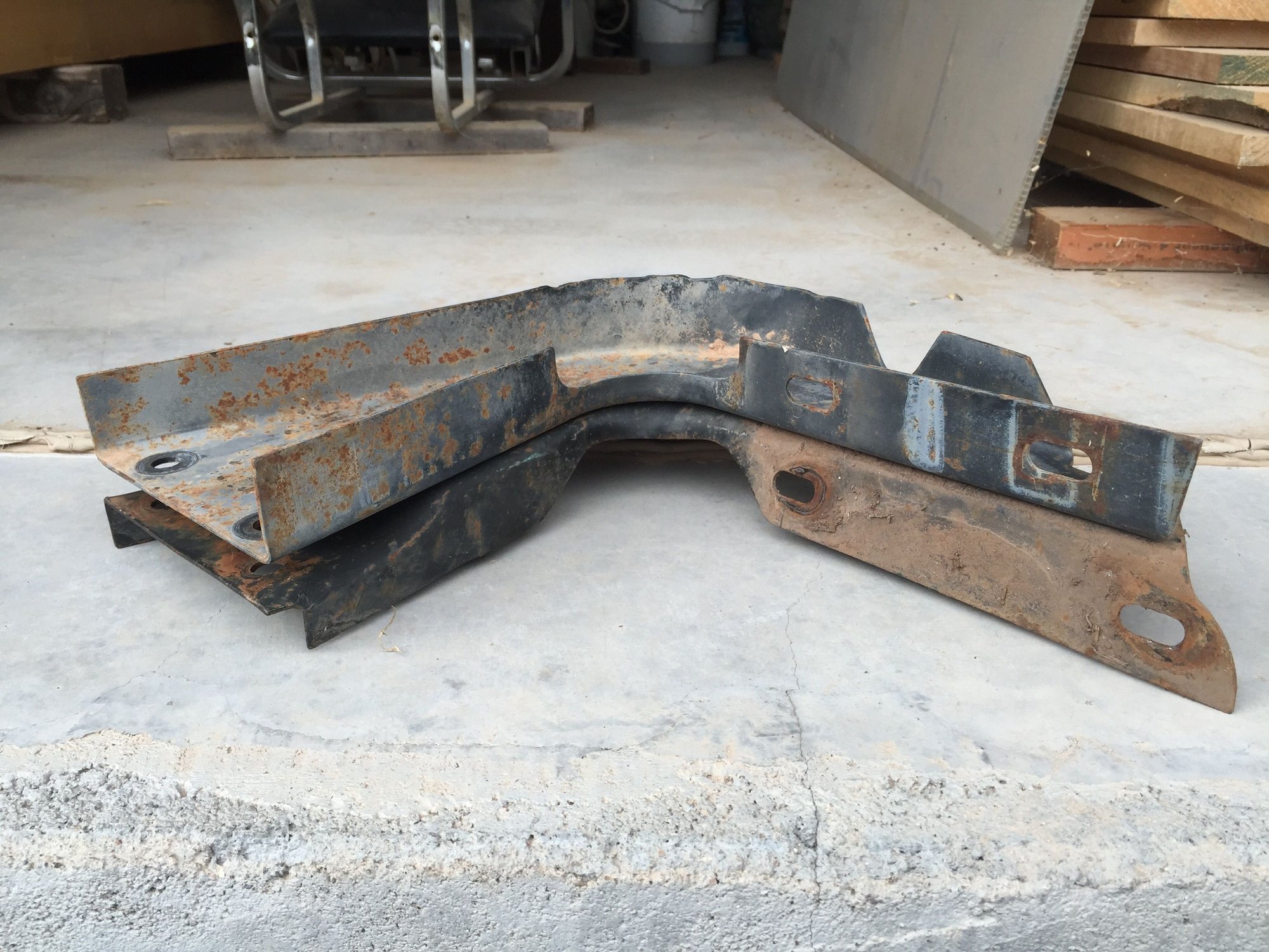

Well, life has been throwing rocks at me... I hit what looked like a clump of mud in the dim twilight and punched a fist sized hole in the cast aluminum oil pan of my TDI Jetta So I towed it to my parents' house where I can work on it next week... I had pretty much zero time to pull or mess with the brackets, but I did compare them and they are almost identical. The only difference I could see is that the upper mounting area is notched in slightly on the '73 bracket whereas the '80s bracket is flat on the back. I think a piece of plate to shim it flush is all you would need.

Forgot to attach the pic...

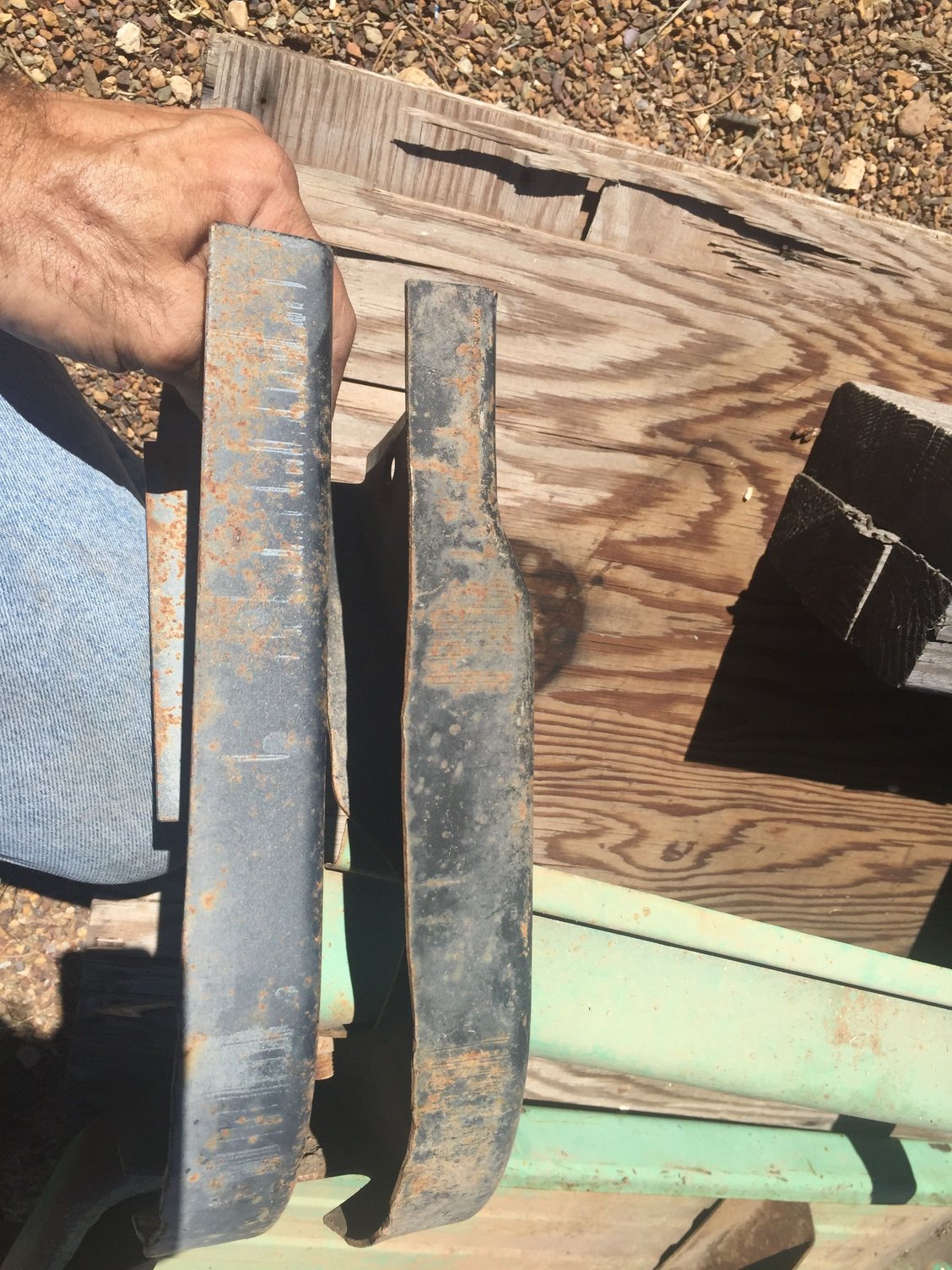

Bump on this thread... I changed the oil pan on my Jetta and had time to pull the brackets this time. Definitely very close. Looks like a plate or spacer at the top to off-set the notch, and one of the step bolt holes needs re-drilled because the step is deeper on the 70's bed. The tip of the bracket might need trimmed off if it is too long. All very minor changes.
