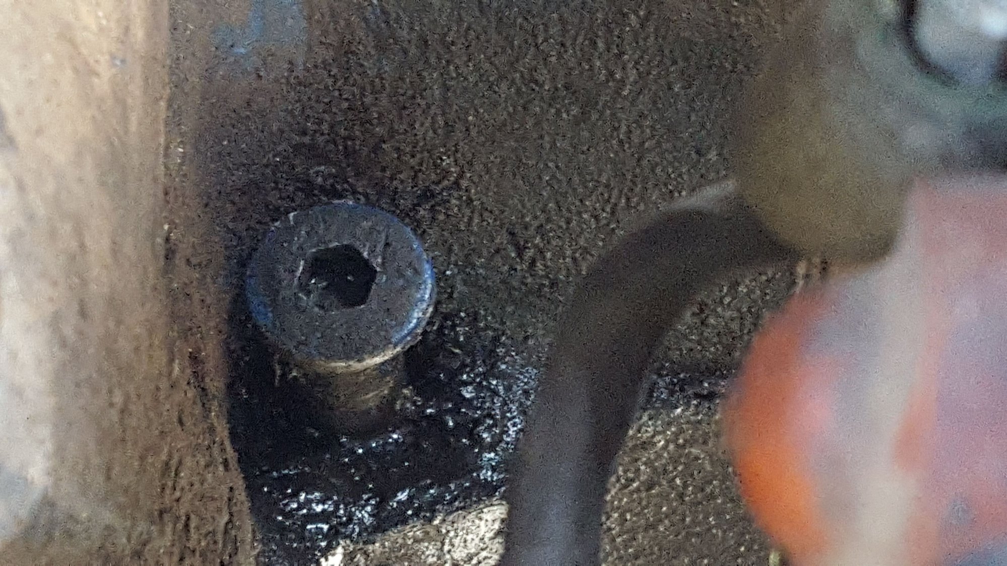

Can someone help me out. I have no idea what this bolt is. You can tighten it down but its in some kind of rod that slides out. Trying to put and end to these oil leaks. This is located where the yellow dot is on the second picture. The motor is a 351m<br/>

Maybe the car version of this motor has a passenger side dipstick and that closes it off when it's used as a truck motor? Other than that I have no friggin idea

That is where the dipstick goes if you do not have a 4x4 engine, there is a press in plug that was there if the dipstick goes in the side of a rear sump pan, someone just stuck that bolt in there and likely gooped it but it does not belong

Okay thanks for the reply. So i should be able to remove it and the rod and tap it with another bolt or find that press in plug?

you'd be ok redoing the sealant with another bolt/that bolt, or finding the right press in plug, either way would be ok

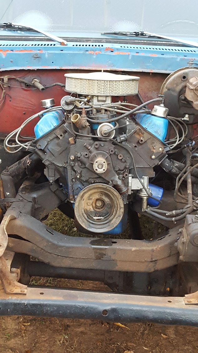

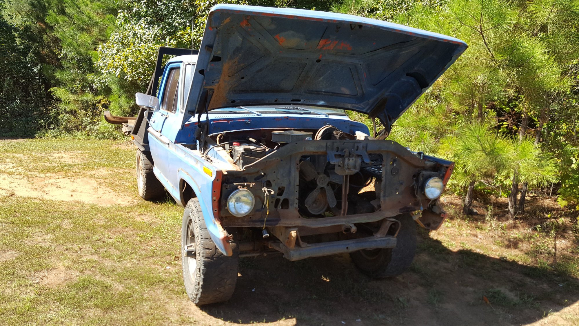

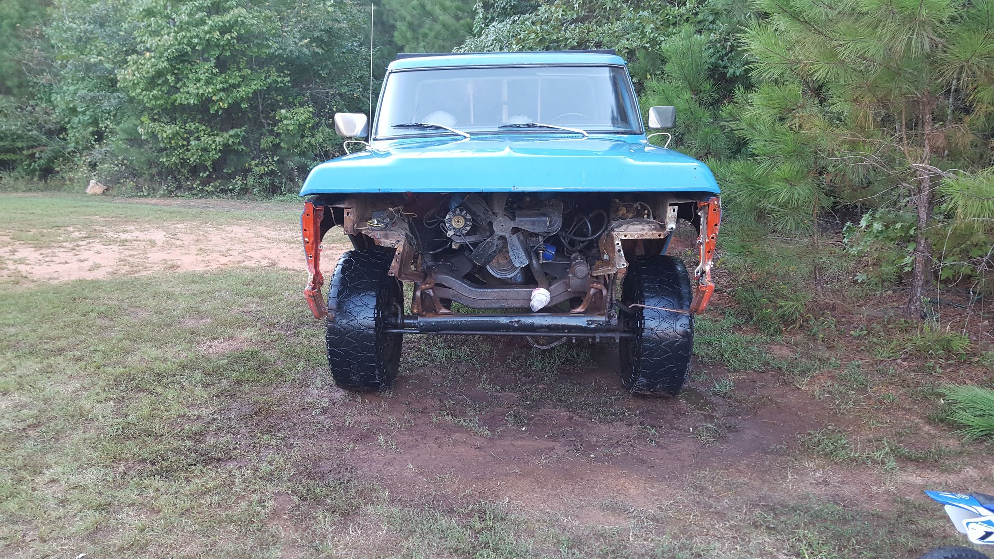

Well ive gotten carried away and decided might as well take advantage of the whole front of the truck being torn apart. I picked up an engine hoist and stand today. Got it ready to pull in the morning. I was very pleased the headers came off without breaking a single bolt. A month of soaking with pb blaster must have paid off. Now just time to decide how deep to get into this motor. This is all a first for me. I dont have a ton of funds to thow at it right now, but i really want to do the cam, timing chain, crank, and pistons. Father in law is getting the heads done for me free of charge. Here is where im at.

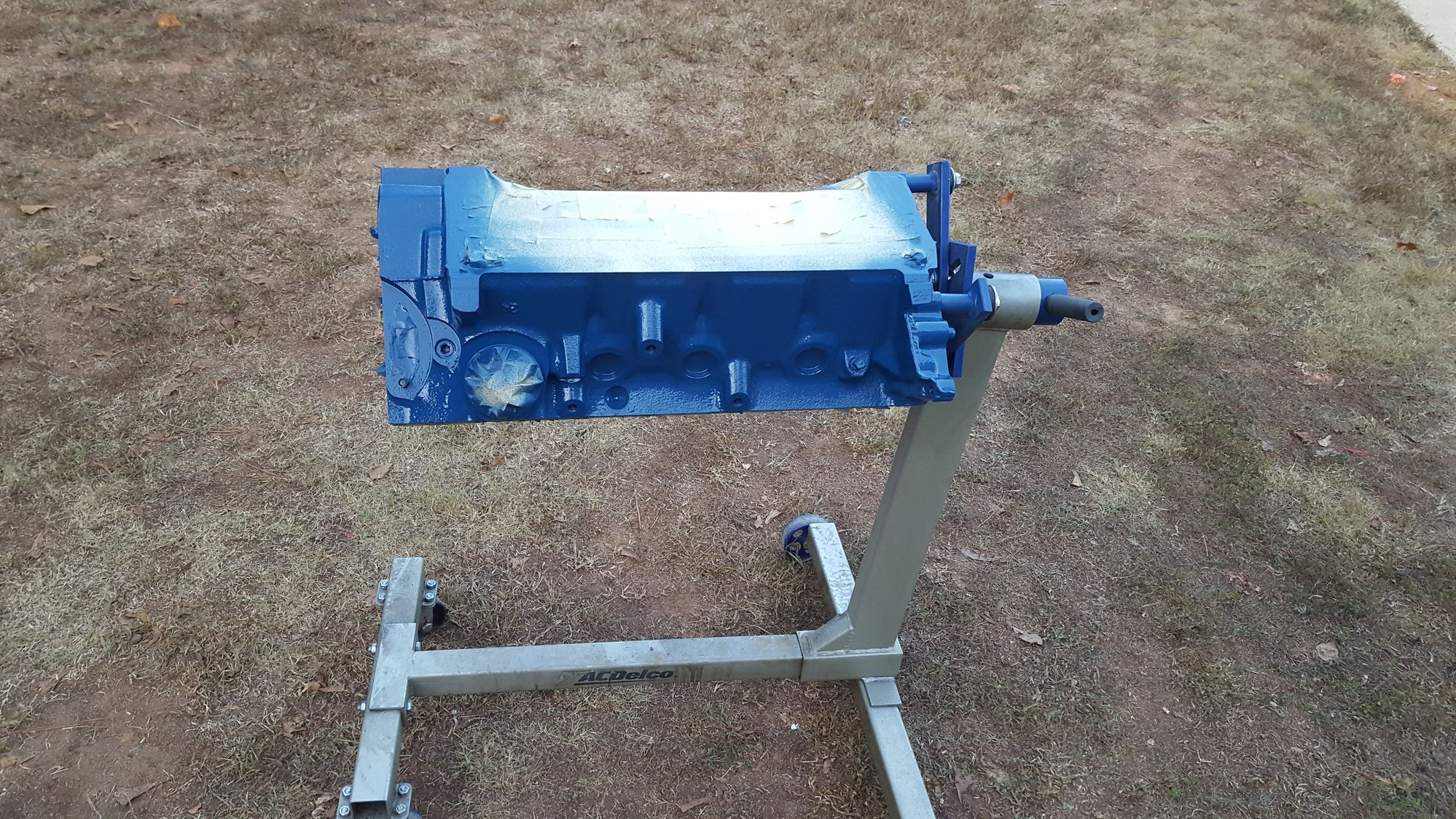

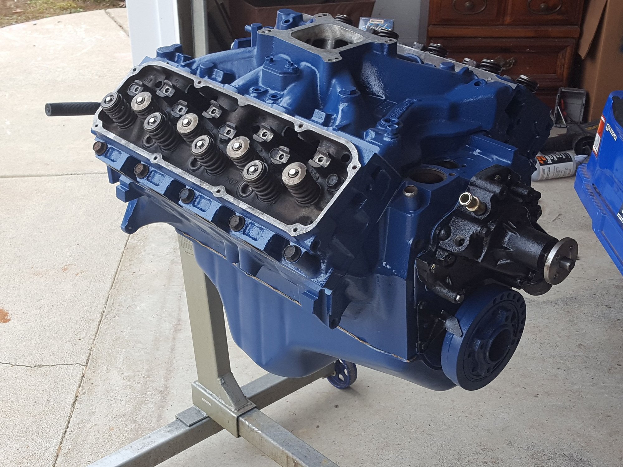

Well im finally getting somewhere. I just went through and replaced all bearings, new rings, new cam, new timing set, and new water and oil pumps. Hopefully the cam will bring a little life to this 400.

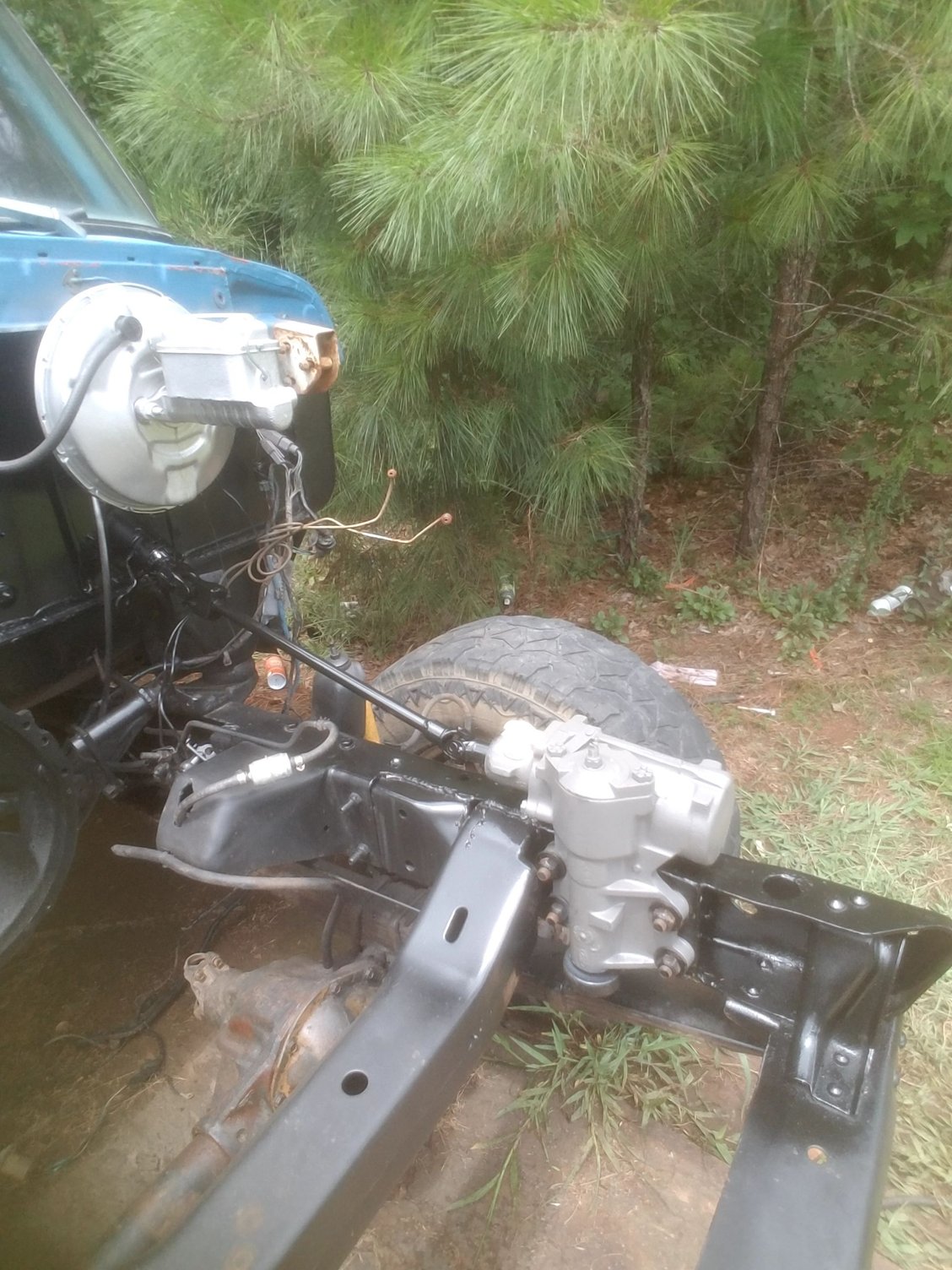

Finally completed the long awaited power steering conversion using a 78 f250 4x4 box. Not much to it it, hardest part was finding the box.

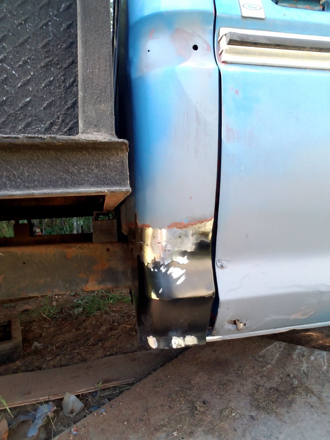

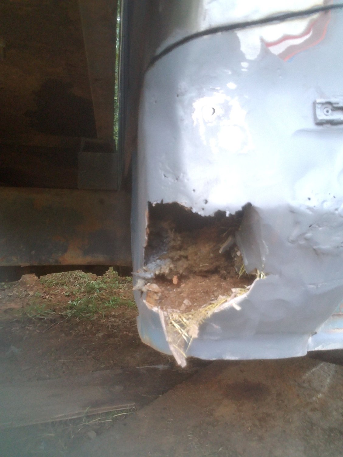

Got around to a little rust repair today. Old cab corner had rotted through and had dirt and everything else inside. I cut it out using the new one as a template. I also took the chance to spray the inside of the pillar with rust converter then some rattle can to top it off. New one welded up no problem. Pretty easy for my first corner replacement. I just can't believe I was thinking of bonding to cover the problem.... glad I was able to talk myself out of it. Now time for new doors.

I'm glad you decided to talk yourself into fixing the problem the correct way also. However I might add that once the truck if finish painted you coat these areas with a good cavity wax to help prevent the problem from ever reoccurring.
