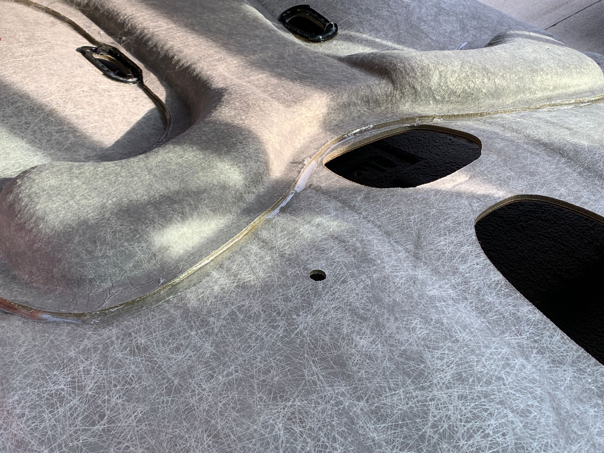

Doesn't make sense. The ceiling duct is one big spider bubble poorly glued to the top of the headliner. So unless there is something blocking one or more of the register outlets or the branch to the middle (diverter door foam?), they all flow together.
