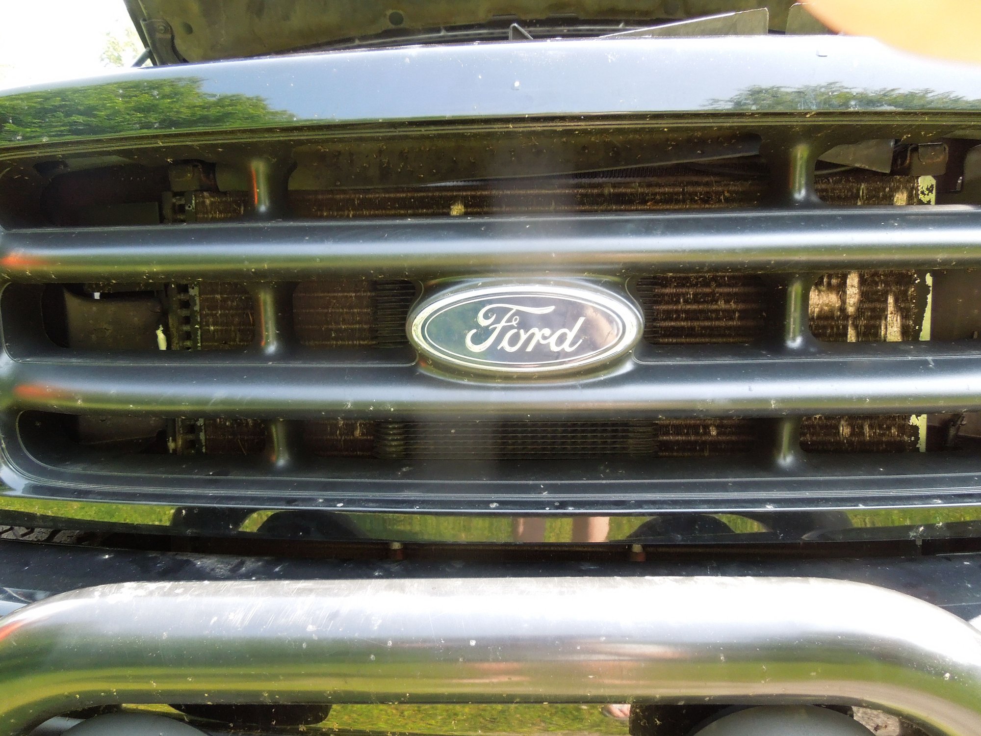

So I have tried to research my problem and I cant seem to find a solution. I purchased the truck over a year ago and never had a problem with the transmission. The only issue was a leaking transmission pan gasket so I changed it put the same fluid that came out back in it since it looked brand new and didnt smell burnt or anything. So fast forward time and my girlfriend was driving the truck over the winter and lost control of the truck and spun it around and hit the front end of the truck into a rock wall.I have a weston bar on the front end that took the majority of the hit. Shortly after the transmission would start to run warmer than normal. It would be 20 degrees outside and my transmission temp sensor would be reading around 140. Now that the weather is getting warmer the transmission is heating up a lot more. I took it to a guy to have him look at it and thought maybe the cooler was clogged or something like that and possibly put a larger cooler on it. He called me up a few days later and said their was a larger cooler already on it but it was not hooked up. It is a black one mounted on the front of the radiator. He said he cut the lines off of the old one and there was a slight bend in the one line so he cut a little higher than that line and then hooked up the cooler.He told me he blew in the lines and there was no restrictions in it, i guess no pressure when we blue on the lines. I drove it home and the temp went higher than ever before up to 220. The cooler on the front was ice cold and trans pan was hot.I am starting to think maybe the bypass is bad and the fluid isnt getting to the cooler. The fluid is still pink and does not smell burnt so I want to fix the problem before any issues arise. The truck has 137000 miles on it. Any help would really be appreciated. I have attached pictures of the cooler that he said was already there but not hooked up.

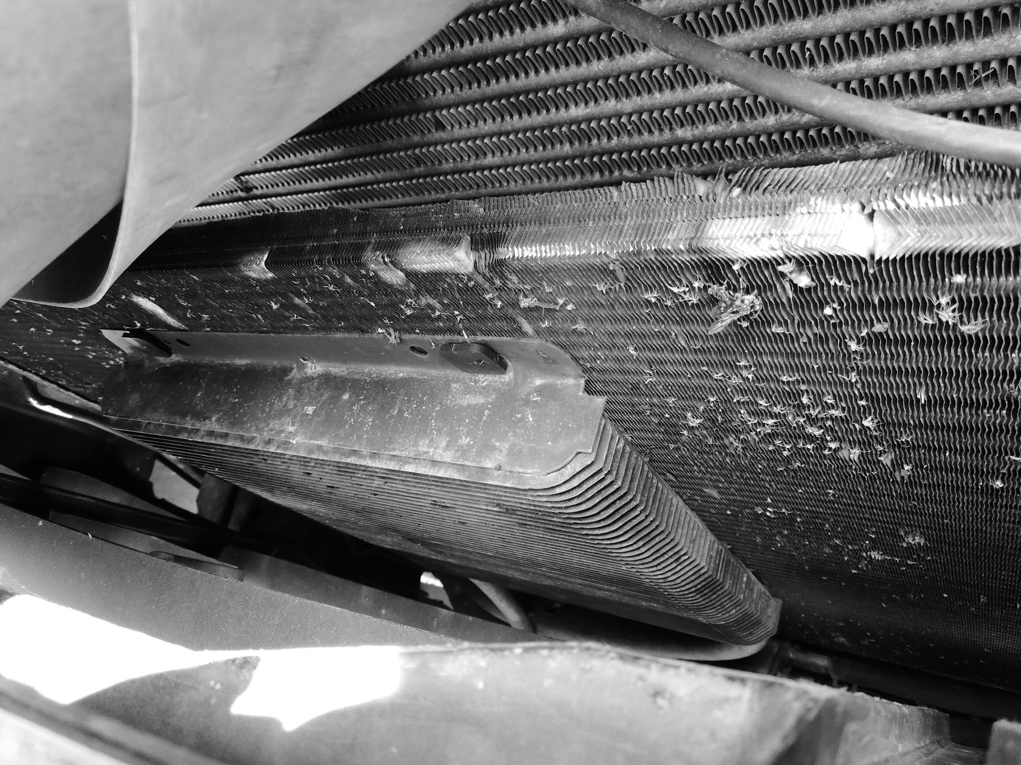

So, do you have ANY cooler hooked up? Have you liked?
A Fin Comb wouldn't that AC Condenser either.

Don't recognize the cooler but it doesn't look to be much if any larger than the stock one. If your guy hooked that on in series with the stock cooler it would most likely be your extra heat problem. Too much restriction to fluid flow. I did not see your year model. Do you have the transmission oil lines to the radiator as well?
