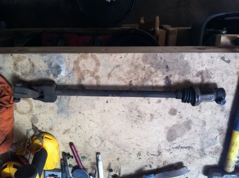

78 lower steering shaft ujoint
Does anyone have a part number for a replacement ujoint ford or aftermarket. Cant seem to find a 3/4 32 spline to 3/4 smooth bore. Dont wanna buy the borgeson replacement shaft as it is a custom application and i would hate to cut up a $300+ steering shaft.

There are several different types of the one piece lower steering shaft & coupler assy's.
Is your 1978 a: F150 4WD or F150 Super Cab 4WD or F250 4WD?

1978 f250 4wd crewcab

D8TZ-3B676-B .. Lower Steering Shaft & Coupler Assy / Obsolete
This is a one piece assembly, Ford did not furnish any individual parts for it.
Last MSRP: $509.32 ~ Dealer net cost: $305.59 // Applications: 1978/79 F250 4WD & 1979 F350 4WD
FORD PARTS ONLY in Bayamon Puerto Rico has 1 = 787-786-9180 / No one else has any.
Most people replace the original with a Borgeson shaft.

Get the Borgeson shaft and measure it x3 and cut once. It is well worth the $ and can be bought for under $300. Or have you checked Flaming River for that u joint?
Double Universal Joints - 3/4" DD X 3/4" DD Double U-Joint - 3/4" DD X 3/4" DD Double U-Joint - Polished
http://www.summitracing.com/search/p...ering-u-joints
http://www.jegs.com/p/Borgeson/Borge...55261/10002/-1
