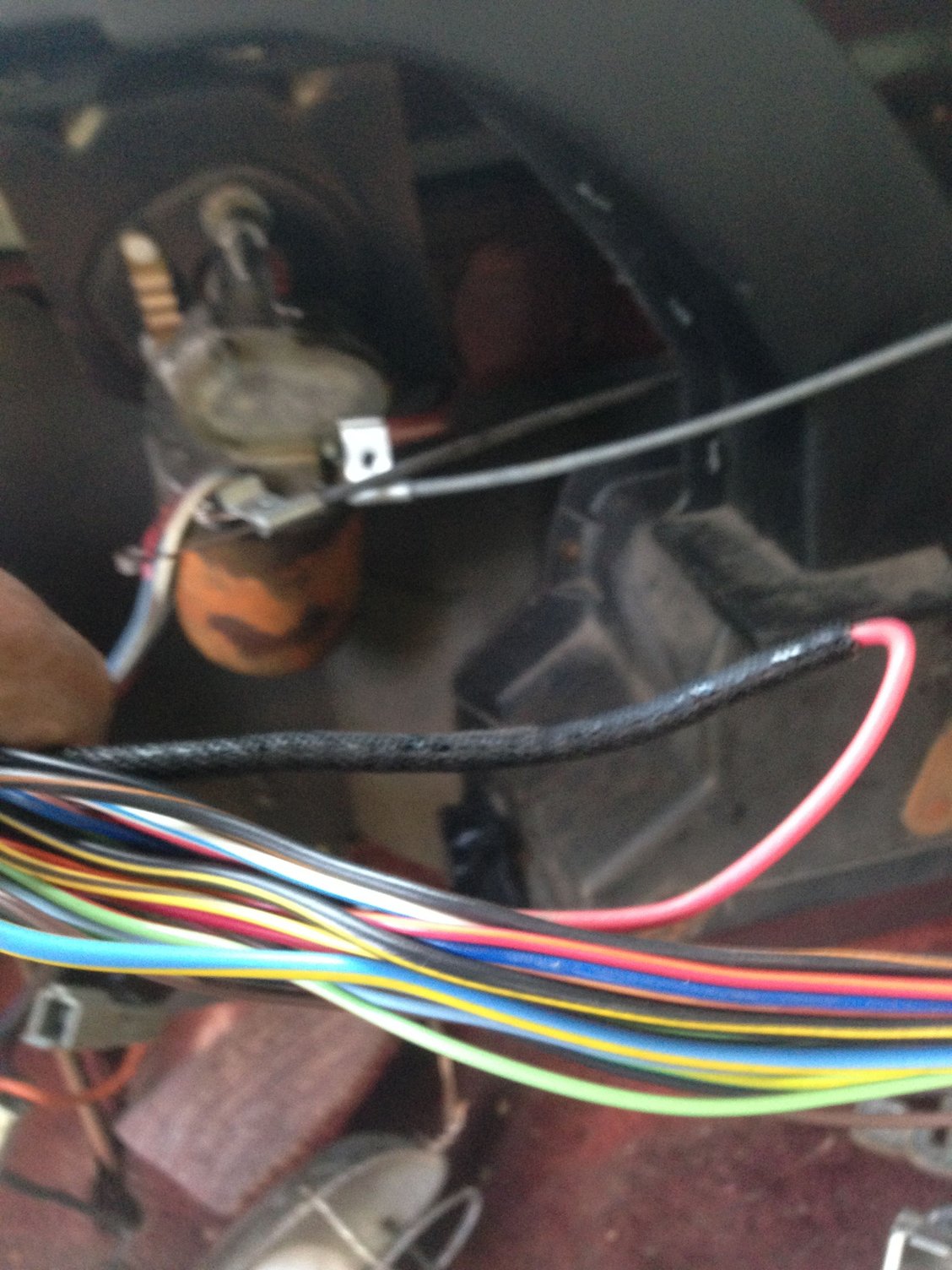

I received the new switch today and installed it. Same problem. I took apart the dash and found a hot wire (in temperature).
The red wire coming out of the switch is hot. I started to follow it toward the passenger side where it picked up some insulation.
The wire looped back toward the driver side at about midpoint in the cab.
The red wire came to a tee where three wires met. In this picture, the red hot wire is the one facing down. The two color wire on the top goes through the firewall to under the hood on the driver side. The brown wire to the right goes back toward the passenger side and exits to under the hood
It this a fuseable link gone bad?
What is this? I am going to look at a wire diagram now.
