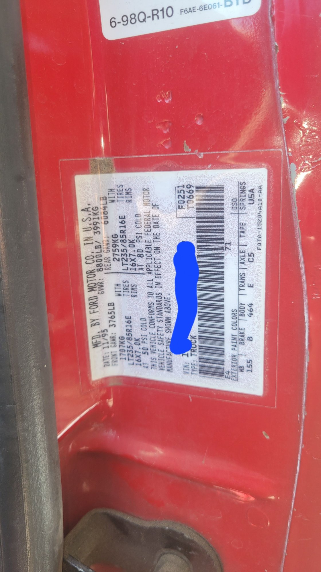

I'm confused because I have a 96 f250 that has the 10.25 Semifloater, is over 8600gvwr, and has the big block so which drums do I buy?
That should never be the case. Are you sure you know what a semi and full floater look like?
You're either mistaken or someone replaced your rear axle with a lighter duty one and you should swap a full floating rear back in it (they're cheap enough and always use new U-bolts).....along with the wider 3" brake shoes.
If you don't haul heavy and or wont swap the correct rear back in, then the semi floater that someone swapped in, uses the 2.5" wide brake shoes. Don't buy the 3" shoes the truck originally came with, because they wont fit now. That rear doesn't belong in your truck. Someone needlessly ruined it and since it's a very affordable (and easy/fast) fix, it should be fixed.
My F250 has a F350 DRW rear in it now. I can't buy the 3" shoes my truck originally came with either. You have to buy shoes for the rear that's in there now. Take your drum off and measure the shoe. You'll see.

on my vin sticker it says it has the c5 axle which is the 4.10 semifloater. I checked the size and they're the 12x3" drums. Also it has the cylinders that stickout of the wheels like the full floater so maybe the previous owner swapped it?
