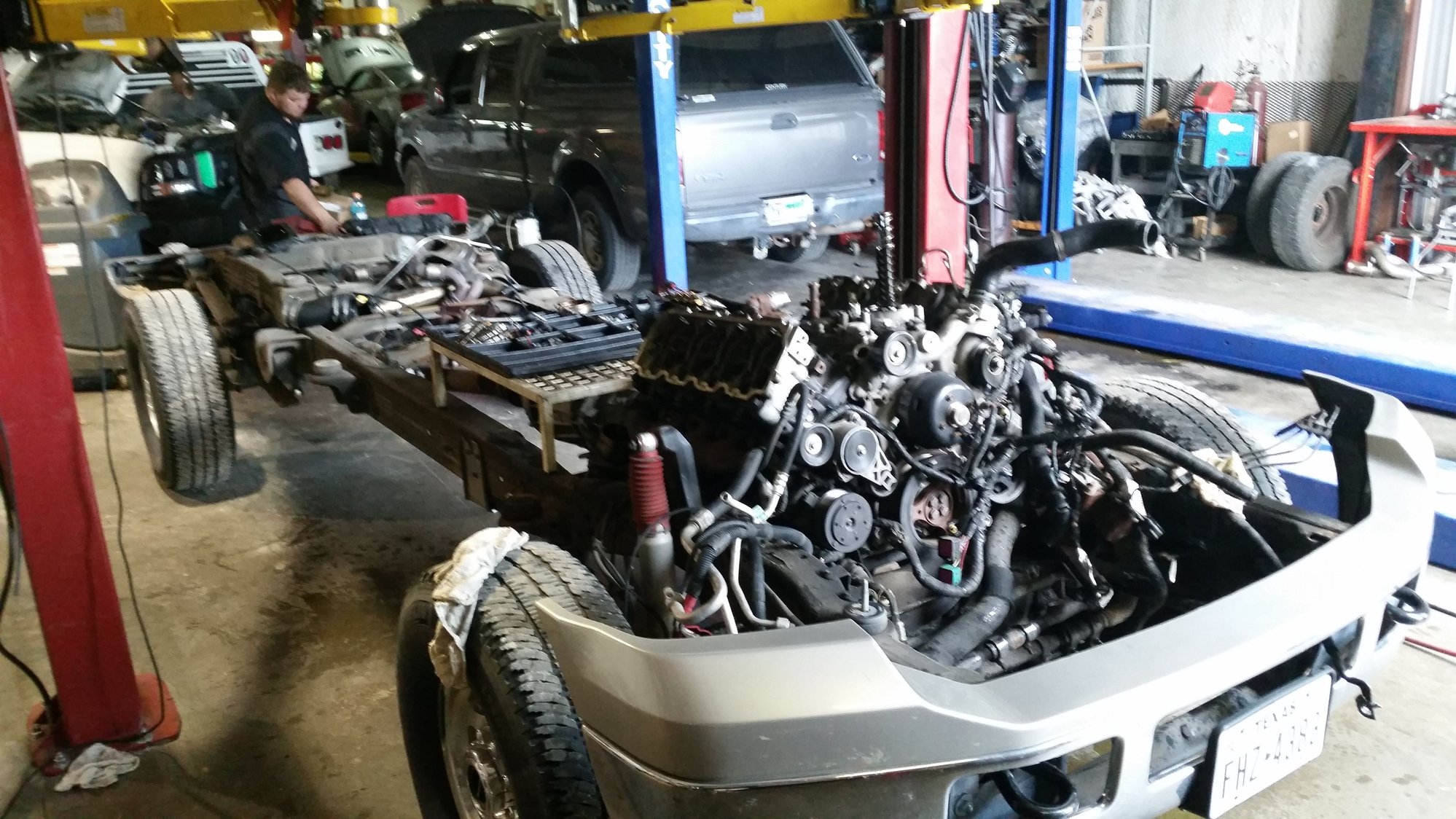

Well my 2005 went in for blown egr cooler and head gaskets. It's getting arp head studs, ford oem head gaskets, egr delete, sinister coolant filter kit, turbo rebuild, 8 new injectors ( didn't have to do them But I decided to bite the bullet while it's apart), new Ford oil cooler, sct x4 tuner, pyrometer guage, and a new waterpump. Hopefully I'll be good to go for a while.

So that's how you get more elbow room under the hood

So much I would want to do to my truck when it would be separated like that. I am sorry for you for the bill though.

shop
Who is doing the job and where? How'd you choose the shop? Thanks.

East texas fuel injection in Longview, texas. I had a couple of friends who used them and where pleased with there work.

It works great too. Get the ball valves as well. Great pics of the cab off.
X2 for More pics!!
