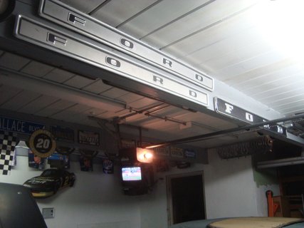

X2 on its screwed on from the inside or back side of the tailgate with phillips head screws. And yes if the screws are stripped use a chisel and cut the head off or a drill and a slightly bigger drill bit and drill the head off.
They also make great man cave decorations!
I spy something that is red attached to one of your tailgate panels, is that factory or dealer or aftermarket!?
They do indeed. This one is my spare.
