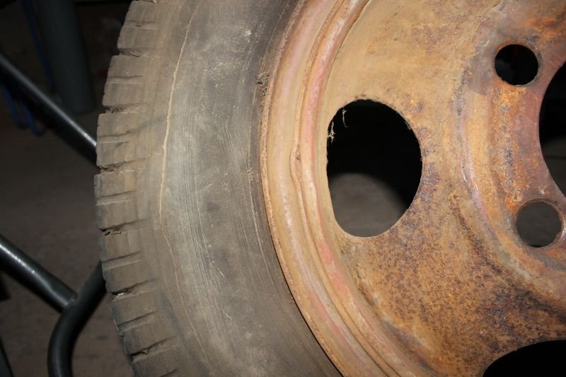

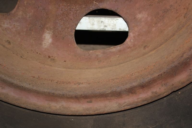

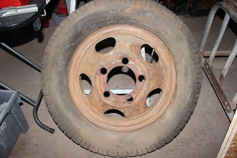

I'm pretty sure my rims are not RH-5°, but before a friend of mine will remove the tire, I want to make sure that I'm right. Looks like a 3 piece lockring rim to me.
These are my wheels (pictures show one outer rear wheel of my 1940 1.5 ton):

Looks to me like my 2 piece rims. the real danger is airing them back up, after installing the new tire and putting the lock ring back in place, I loosely wrapped a chain thru the holes in the rim and around the tire leaving just enough slack so the tire could properly inflate. this way if the lock ring blew off the rim stuff wouldn't go flying. then i let the wrapped tire an rim sit for a bit just in case.

Those are not Firestone RH-5° rims. They are Firestone RH rims. Big difference even though the names are similar. They require care in service, as described above or through use of a cage when airing them. Stu
