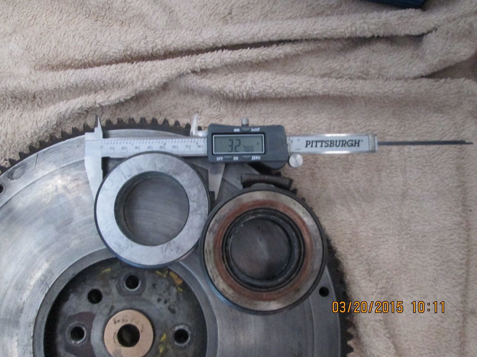

I can not offer any input on which TO bearing to get. Just make certain the contact surface of the TO bearing fits the working surface of the clutch fingers so as the angle of the fingers changes the contact remains on the working surface of the bearing. The picture you show of the two TO bearings side by side, shows what appears to be different OD TO bearings.

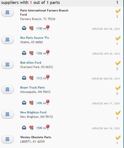

PartsVoice shows multiple sellers with at least one of these TO bearings p/n COTZ 7580-A.
Another thing I've not seen addressed here is the main drive position. Is it being held firmly in the correct position with the new spacer?
Thanks Ray, I'll have a look in there and see what I can see. I know the picture looks like it's a different size, but I went through my T5 install thread and found this and I had mentioned that the old one I took off and the new one I put on measured out to be the same or very close to it.
Don't go by the number for the OD as I don't have it sitting on the widest point in the picture.
Thanks Joe! I didn't turn up any specs on COTZ 7580-A after a search or 2, but if I did measure it against the one I took off and the one I took off was working with the 11" PP, then technically it should work with the T5 since I'm still using the 11" PP. At least I hope..... I'll keep at it and see what happens.
