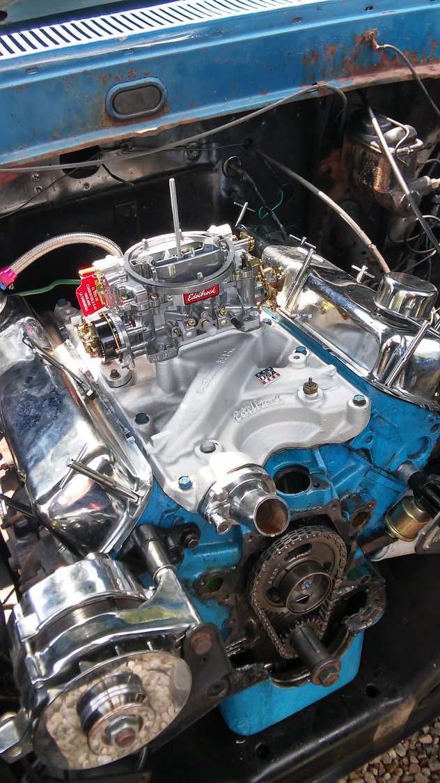

Couple engine pictures!

I'm really curious to see how the headers fit in the truck. And the engine mounts are so far back on the crossmember, I can't believe the engine will clear the firewall. Is that how the 351W was mounted before?

Yes that is how the 351w was mounted before. The headers will not fit with out some kind of modification. The headers are hitting the frame and front transmission cross member. I think the headers will clear the starter with slight frame mod. but not sure if there is away to modify the cross member. I will be looking for shorty headers and or a cross member modification.

Those are the same problems I had trying to fit headers. And it appears you're using the 6 cylinder or FE frame mounts so it looks like your motor is set further back, but it's really not. MIne was originally a 6 cylinder and had those mounts. I switched to 302 mounts and had to experiment to get the location right. They make it easier to clear the PS gearbox too.
I think I'm just gonna use shorty headers. That way I won't have to modify the crossmember.

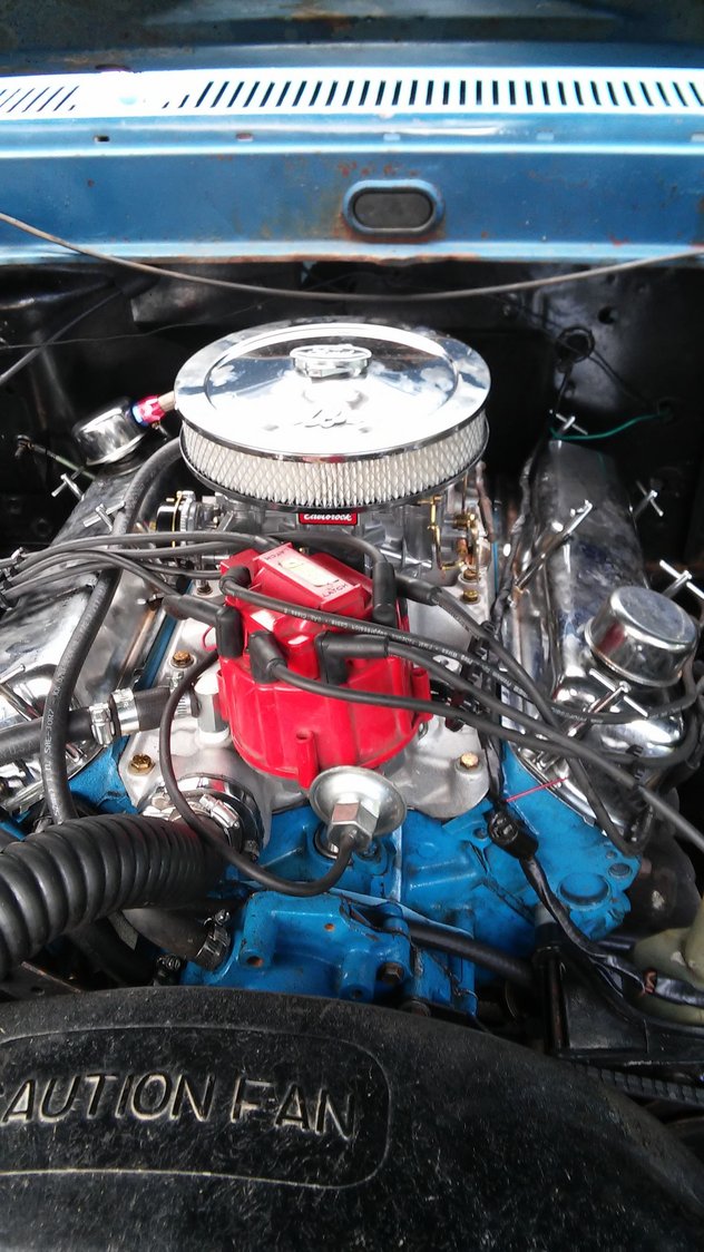

Been super busy with work lately but here are some of the most recent picture. We did manager to get her running again. Still need a little carb and wiring work.

It's been awhile since I posted new pictures. Ole blue has come along way. A little over a year since I got her running. She is now my daily drive. I recently add the edelebrock performer power package to the engine. Runs like a champ. Also picked up a new set of wheels and tires.
