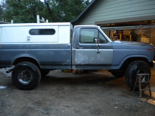

I've been running the 37" Goodyear Military OZ tires for years now on my stock height 86 F350. Tiny bit of the front fender got trimmed off (previous owner had smashed that bit up offroading with 35s). No rubbing or issues at all. Driven them across 4 states now and still haven't had any issues with needing them rebalanced yet. '
They are VERY solid tires so they last a long time, but on that note it can be a PITA to find a tire shop that can mount them if they aren't used to the big stuff. Older picture, but shows how they sit (note that the first picture the bed is loaded and that damn shell weighed a ton).

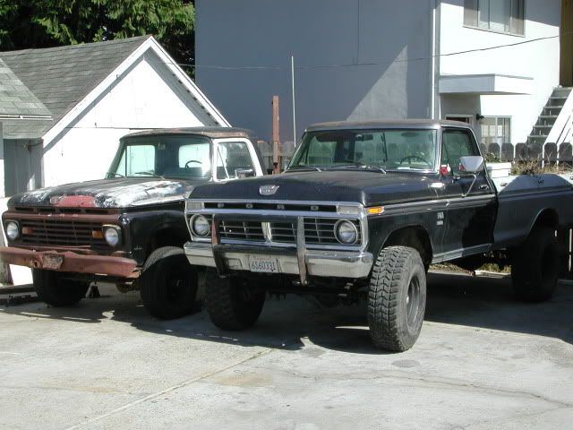

Some tire shops will have a real hard time balancing them, some folks use shot or BB's. X2 on getting the (pic 3)gen 3's Baja T/A's and not the (pic 1) bias ply Good Year Wrangler MTII 36's or the (pic 2) 2 gen 37's, heave tire like 80 lbs a piece.
You can get the stock bead lock rims to fit the rear (D60/D70), the rims are 8 on 6 1/2 bolt pattern, but they will NOT fit the front. They are like 7" off set and will hit the tie rod ends, you can have them recentered though.

Here they are on a stock height '74 Highboy
And here's a little better side picture..
I ordered mine off of ebay.. Got them for $50 apiece, + freight.. Mounted them myself at work, with a lot of help from our cheetah bead seater.. They were too big to fit on our tire machine...
