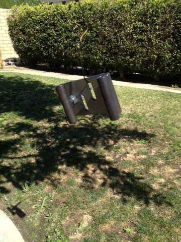

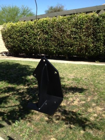

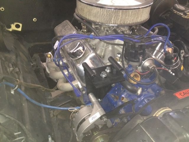

Im doing ac in my 67 with an 86 5.0 block also. I Ordered a kit from nostalgic ac parts. Here is a pic of my compressor bracket and the compressor mounted.

Thanks dude! That gives me a good idea on where to mount it.

I'm not sure. I haven't finished. I'm in the so cal desert so I hope so. The one thing you will need is a double pulley for the water pump if you mount it where I mounted mine.
