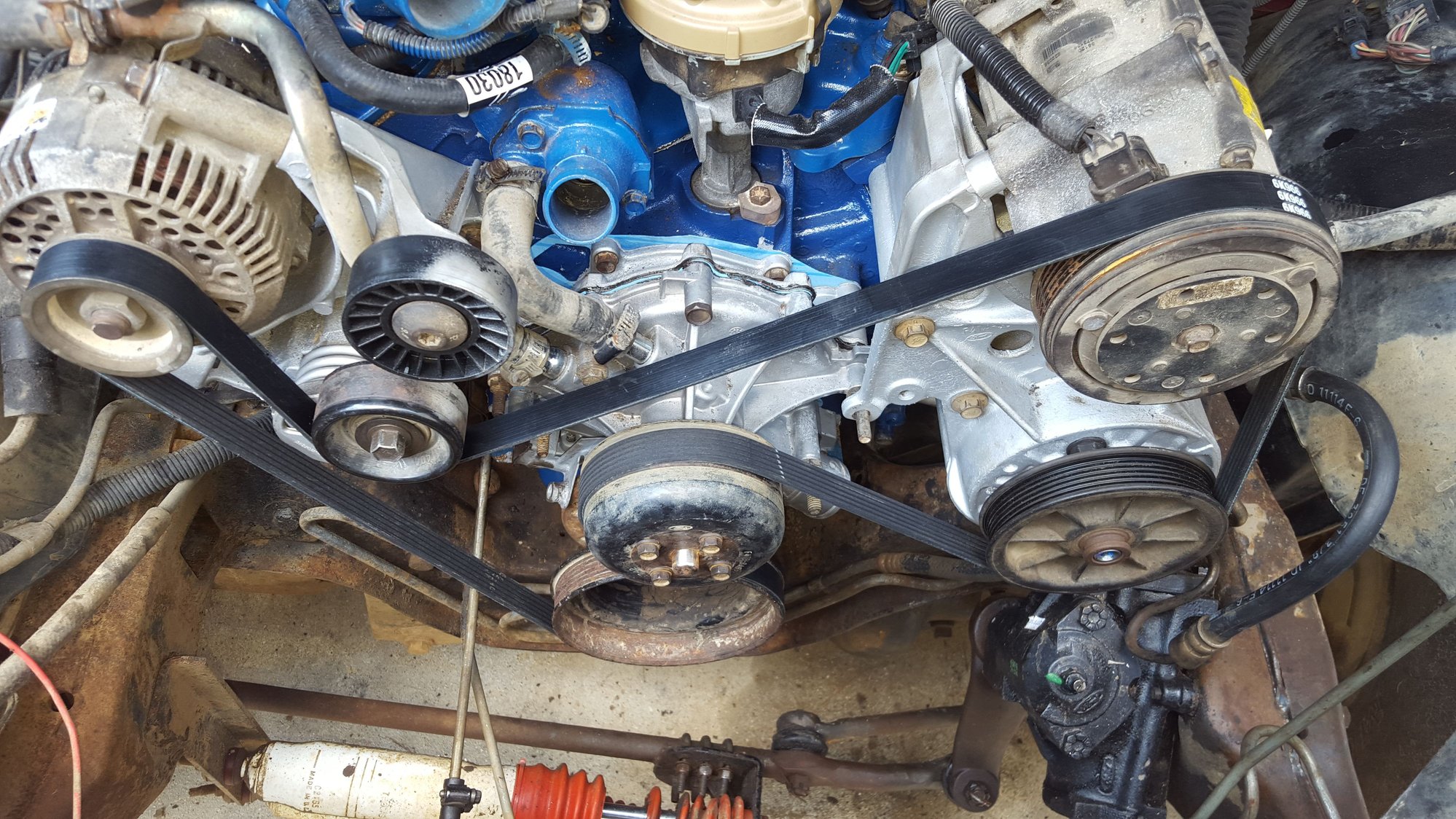

Things on the build changed a little since I decided to get back into motorcycles in the middle of the build, but it came out good anyway. I cut the plans for long tubes and went back with manifolds.I also shelved the plans for the transmission rebuild because if it ain't broke don't fix it. The air pump was no longer needed, so it and all 9 miles of associated tubing took a trip to the landfill. This created the issue of finding a proper belt to run the more necessary accesories, which actually only took three trips to the parts house. If you route the belt as follows, a 966k6 will do the job: from the crank, go straight to the alt. Then from the alt. hit the tensioner, then to the a/c, p/s, over the w/p and back to the crank.
966k6 belt routing
