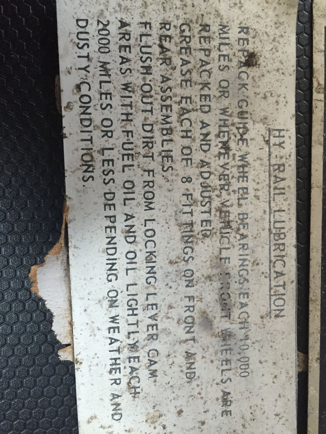

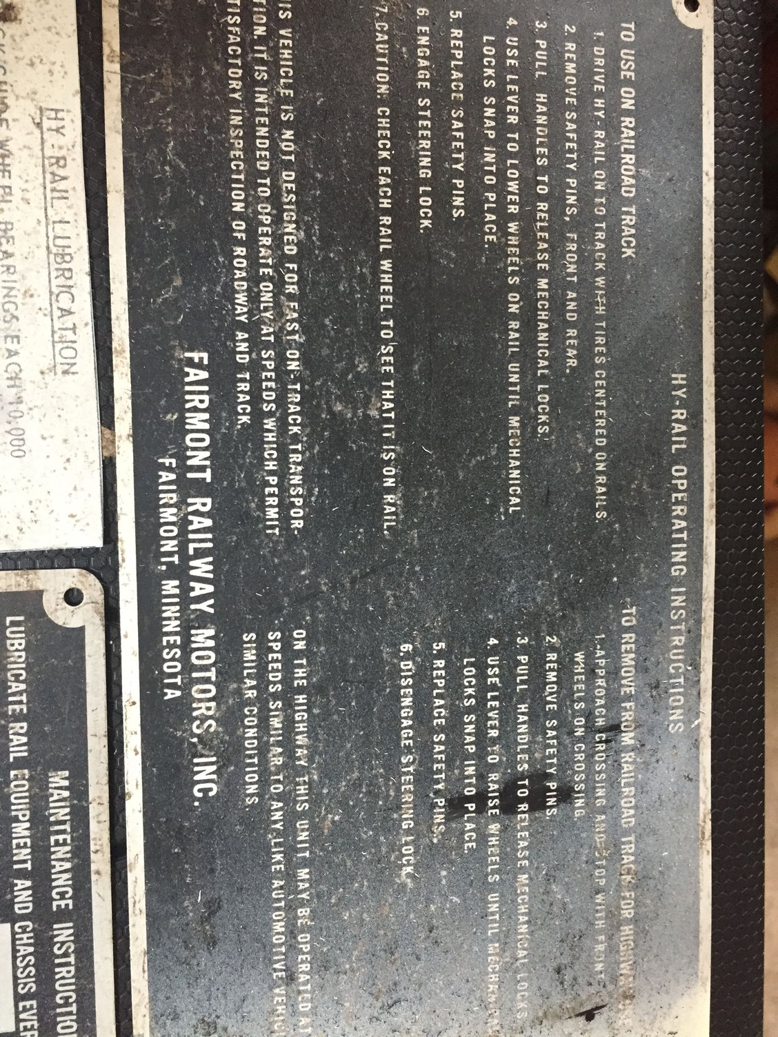

I was playing in the truck and found the manufactures plates for the hy rail system glued to the back of the drivers visor. then I just happened to work on a guys barn and found out he worked for ford for over 50 years and one of his jobs was working with dealers and their special orders. I drove the truck over to him and he was amazed by the truck. he explained to me the truck was a basic chassis order cab,bed,motor,interior. he wasn't able to identify the trans but was going to contact a couple of people that could possibly help. i'm also in contact with the Chicago northwest railroad historical society and exchanging info with them. the truck really messes with people when they look at it.
