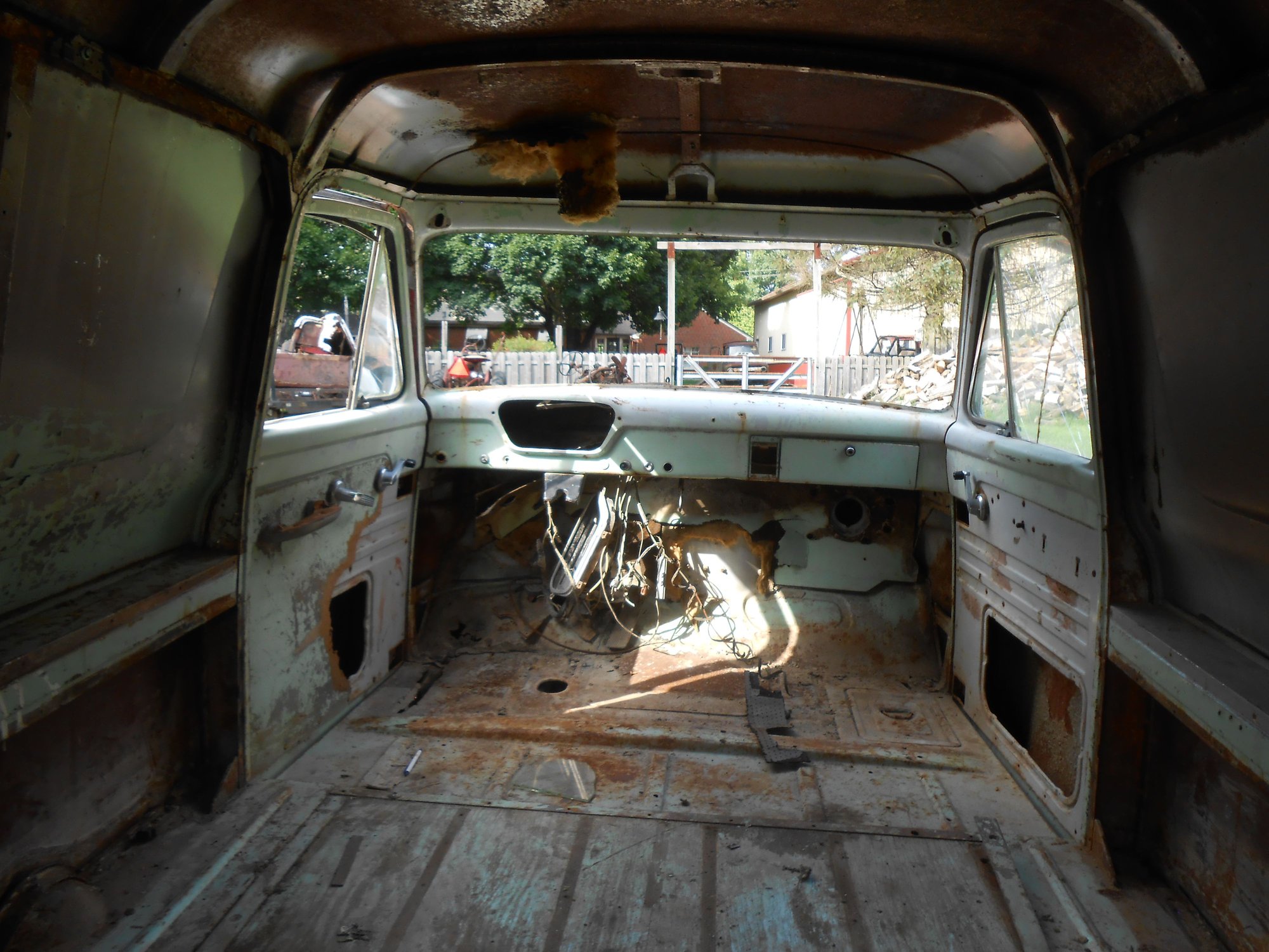

Pics of a custom cab panel interrior, I recently sold this so these are the only pics I have

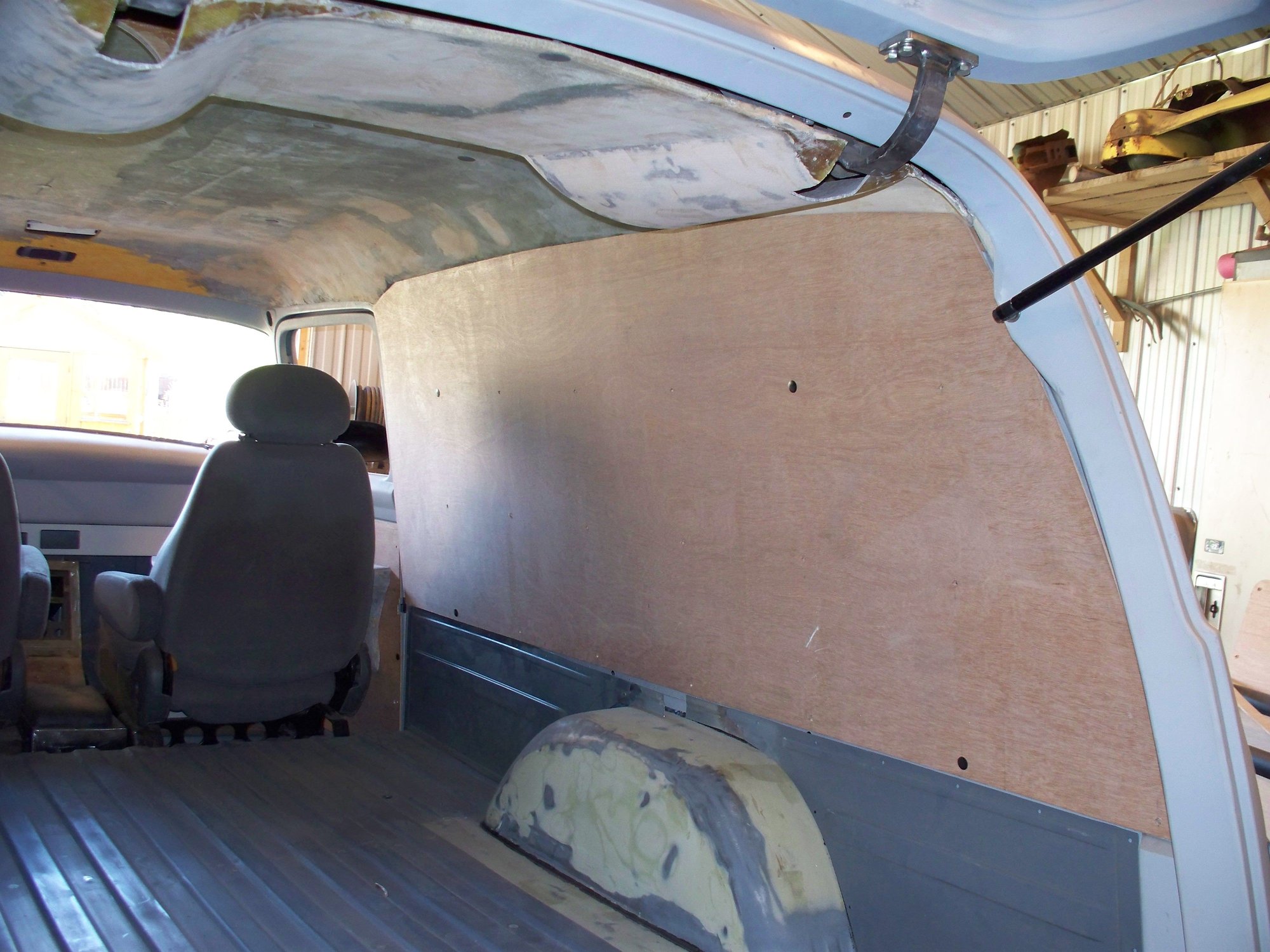

It has been 8 years since I did my panel , So I am not sure how I did it . I had pictures of the build in my Gallery , But can't seem to find the gallery section now . I believe , I shimmed the vertical braces so they where smooth with the horizontal ones . I then used 4 inch wide wainscot boards , and screwed them into the vertical braces with stainless screws and washers . I then built a framework out of 3/4 angle and covered the wheel wells . This gave me a place for jacks and other tools and spares . For the roof I used 4x8 sheet of white plastic shower surround , Cut to fit it could be bent to match the roof braces . I did it in two sections for ease of handling . I glued fabric to the panels then screwed them to the roof braces .
