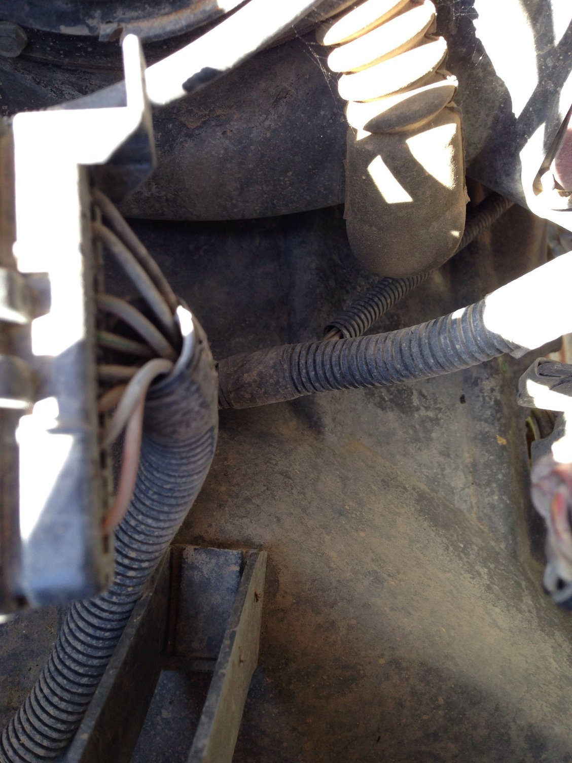

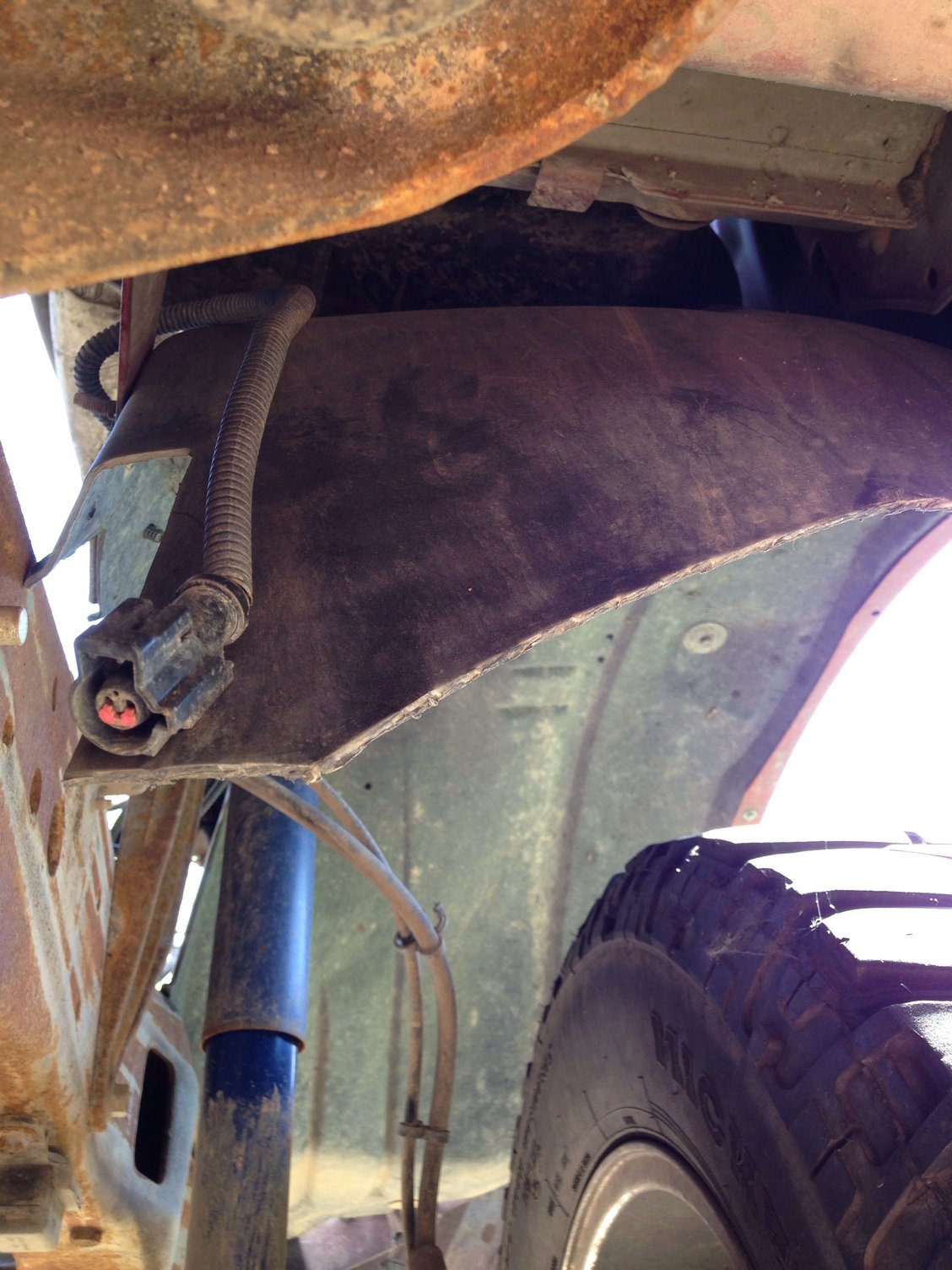

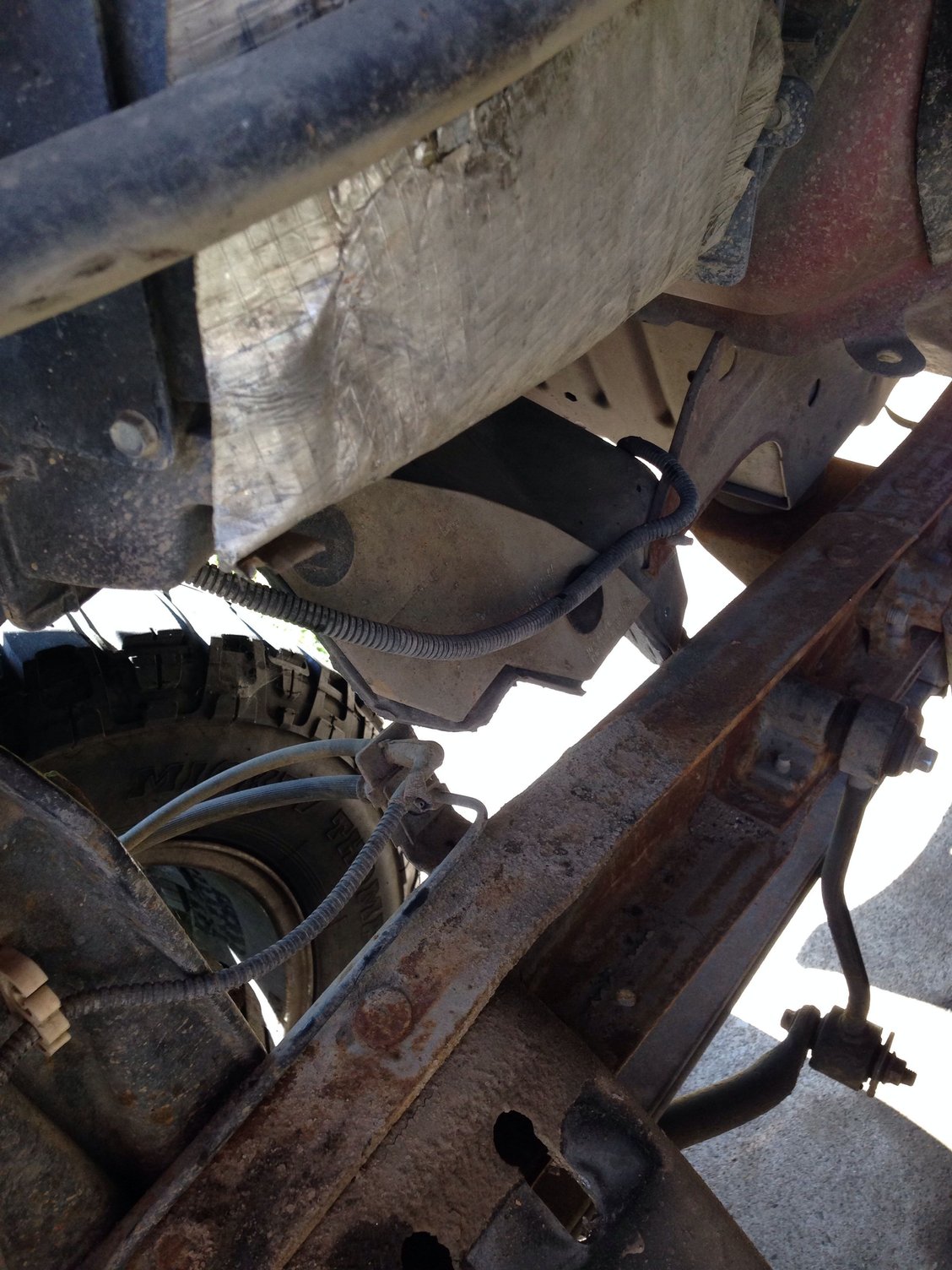

Hey guys. So the other day i was under my truck and noticed electrical plugs behind the front splash gaurds. Anyone know what these might be for? I have a 00 F250 superduty XL model with the 5.4. Thanks!

Here's a picture of them..
Routes up and ties into factory wiring..

ABS sensors
Old May 3, 2015 | 07:05 PM
J_Simmert's Avatar
J_Simmert
Joined: May 2015
Posts: 16
From: Northern Cali
seems like an odd spot for an abs plug
Old May 3, 2015 | 07:23 PM
05F250DSL's Avatar
05F250DSL
Joined: Sep 2013
Posts: 1,303
Likes: 84
It is an odd place but that is what they are. I'm confused why they would be routed and uncapped if not used
Old May 3, 2015 | 08:26 PM
J_Simmert's Avatar
J_Simmert
Joined: May 2015
Posts: 16
From: Northern Cali
yeah. doesnt make much sense.
Old May 3, 2015 | 08:28 PM
J_Simmert's Avatar
J_Simmert
Joined: May 2015
Posts: 16
From: Northern Cali
looked it up and ill be darned. Sure is the ABS.
Old May 4, 2015 | 12:51 AM
Psyclopse's Avatar
Psyclopse
Joined: Jan 2012
Posts: 1,176
From: Indiana
The ABS wires for the front wheels are part of the 12A581 harness (the engine compartment harness). Ford decided to use the same harness for non-front-ABS trucks as they do for ABS trucks (which is weird, because they sure use different harnesses for everything else). On non-front-ABS trucks, rather than have them dangle in the engine compartment where they can get snagged (or confused with something else), they just tucked them behind the liner and hooked them to the liner. The reason they aren't capped, is because they are dead on the other end at the plug. With the sheer number of trucks out there without front ABS, it would have cost Ford a ton of money to cap dead plugs (a savings they likely negated by wasting wire anyway).
