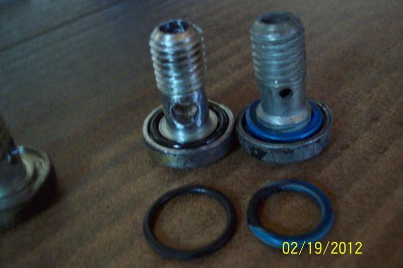

I would see if you can get marine freeze plugs they will hold up better then the steel freeze plugs. And as far as fuel rail banjo bolts Bob at DieselOring has them. Take one of them out and look on this website because there are 2 different banjo bolts and they use different orings. Here is a photo of the different style bolts and as you can see I modded the left banjo bolt on the short shank one.

The plugs you pulled to do the RR FRX is on top od the heads. The fuel banjo bolts are on the front and back for each head. The fuel comes in on top of the head and the banjo bolt transfers it to the fuel rail galley in the head. I hope that made sense?
