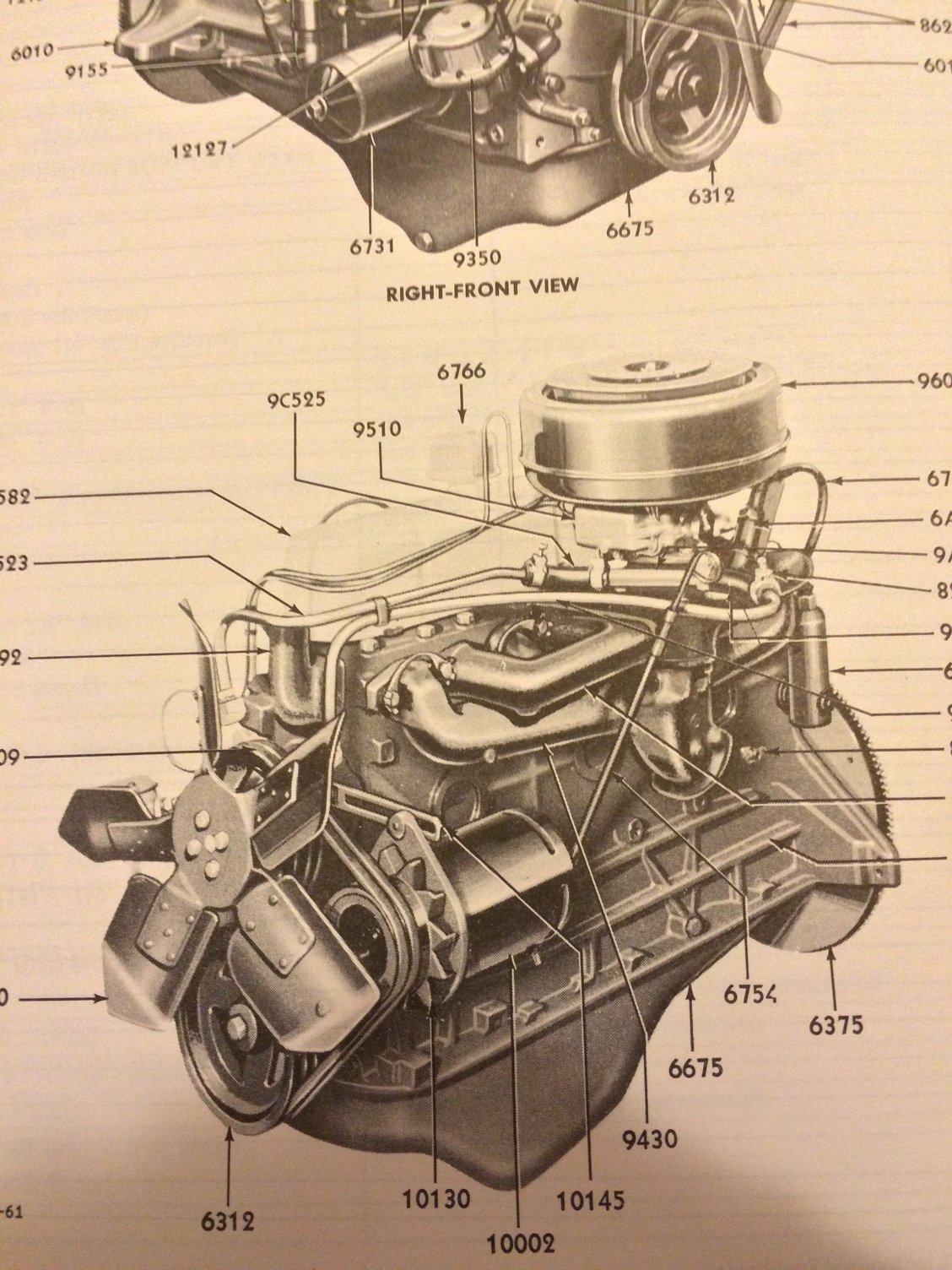

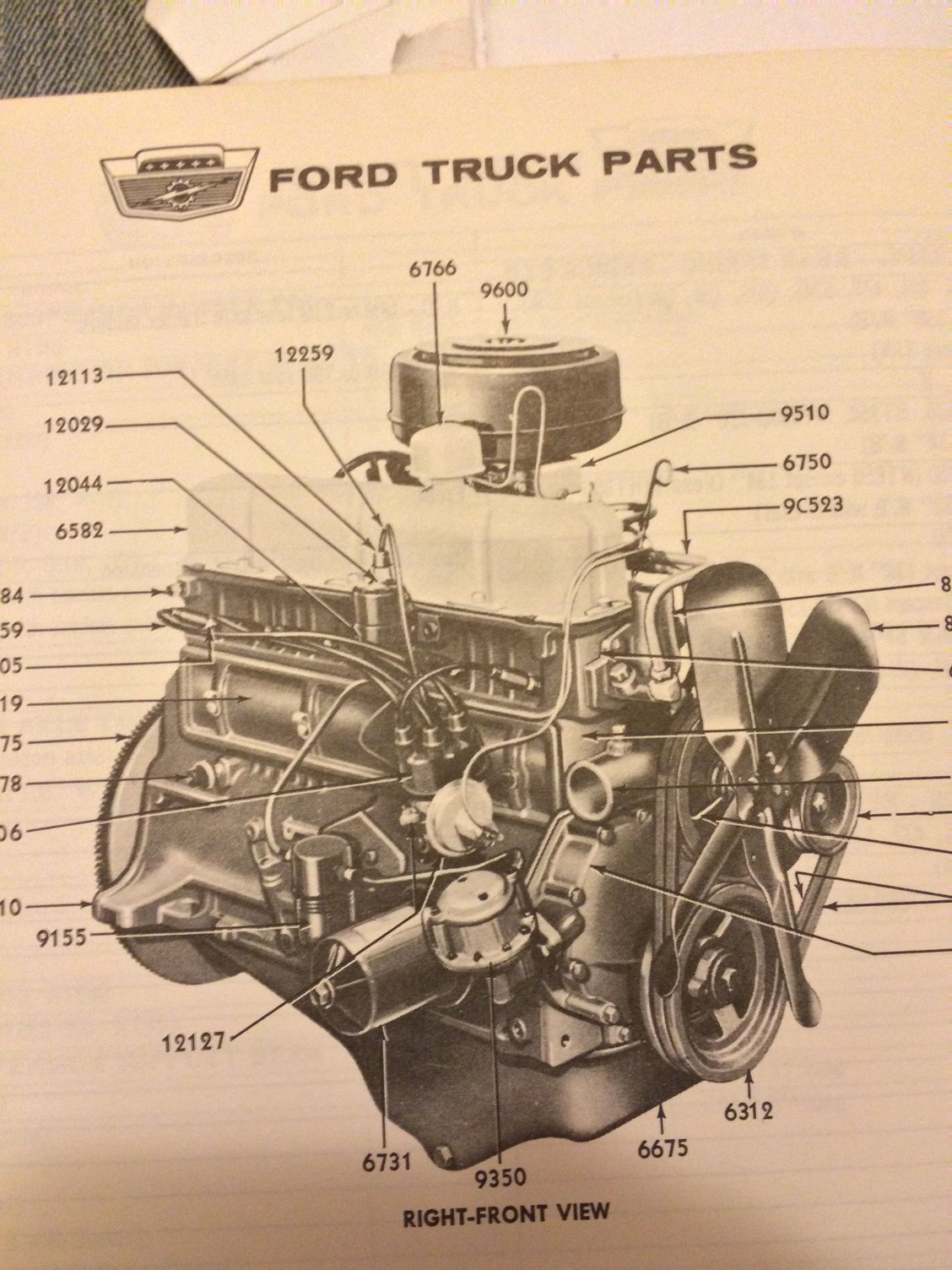

Picture of a 262 out of a 63 parts book.

Thanks for the pics, engine must be a 223, it does not have that second long horizontal rib above the dip stick tube,
