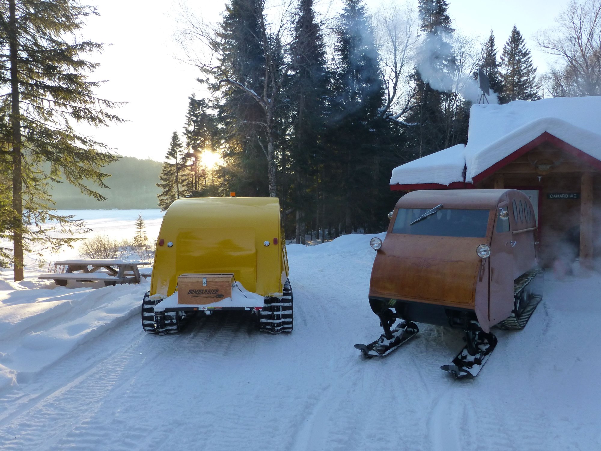

Motor would be going into the machine on the right.

I have no useful information for you as I kept my 300 stock but I am completely in awe of your 1948 snow bus.
Beautiful machine. Good luck with the motor swap.
