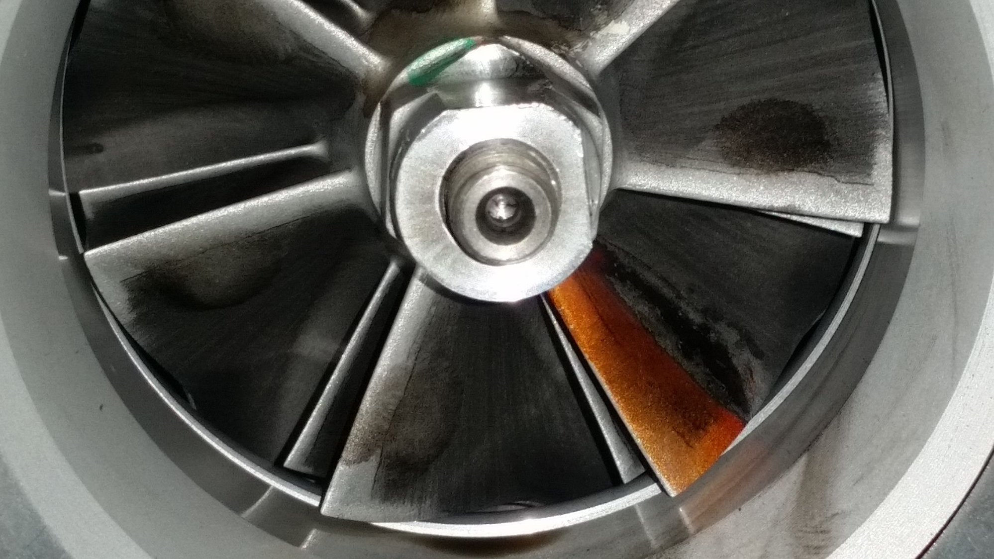

Replaced my air filter today and checked the turbo for loose play and noticed that one of the veins was a different color....is this normal?
Normal or Nuts???

Every turbo I have seen has that funky fin...

Thanks, I thought it was possessed. Oh Goodie!!! another mystery to unravel. Just need more knowledge.

The painted fin is from initial assembly. The hot side also had one painted fin for proper re-alignment on the common shaft after the balancing process is completed.

Thanks to you and Josh I feel better about my 07 turbo, I guess I can postpone my order for a new turbo now. I am always amazed at the knowledge this site brings to the rookies like me. seeing as I have both a 6.0 and a 7.3 I am learning every day. It is like drinking from a fire hose. Thanks to you and all that contribute to this site.
