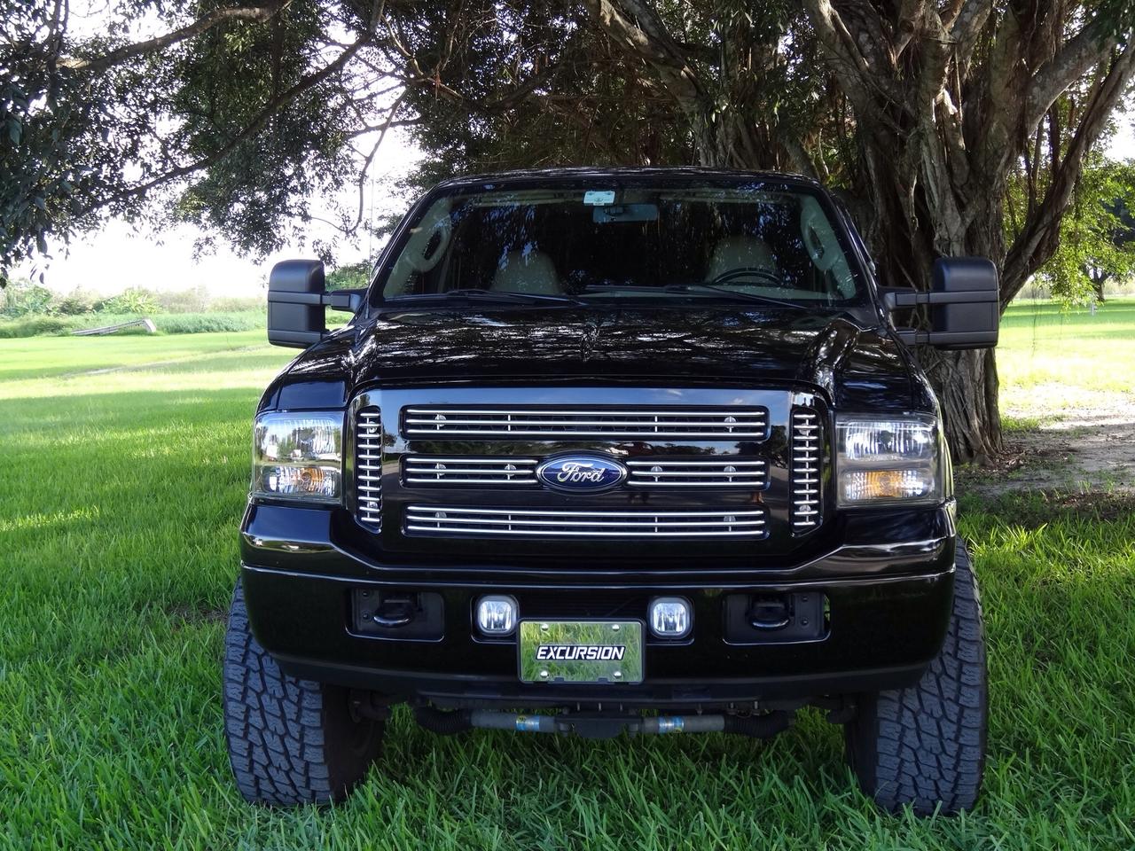

I like my dual Bilstein 5100's setup, but don't know who made the bracket... Here's an old picture.
Attachment 117659
I saw an ad on fleecebay for that same setup. It's kinda like the PMF and Top Gun Customz.
