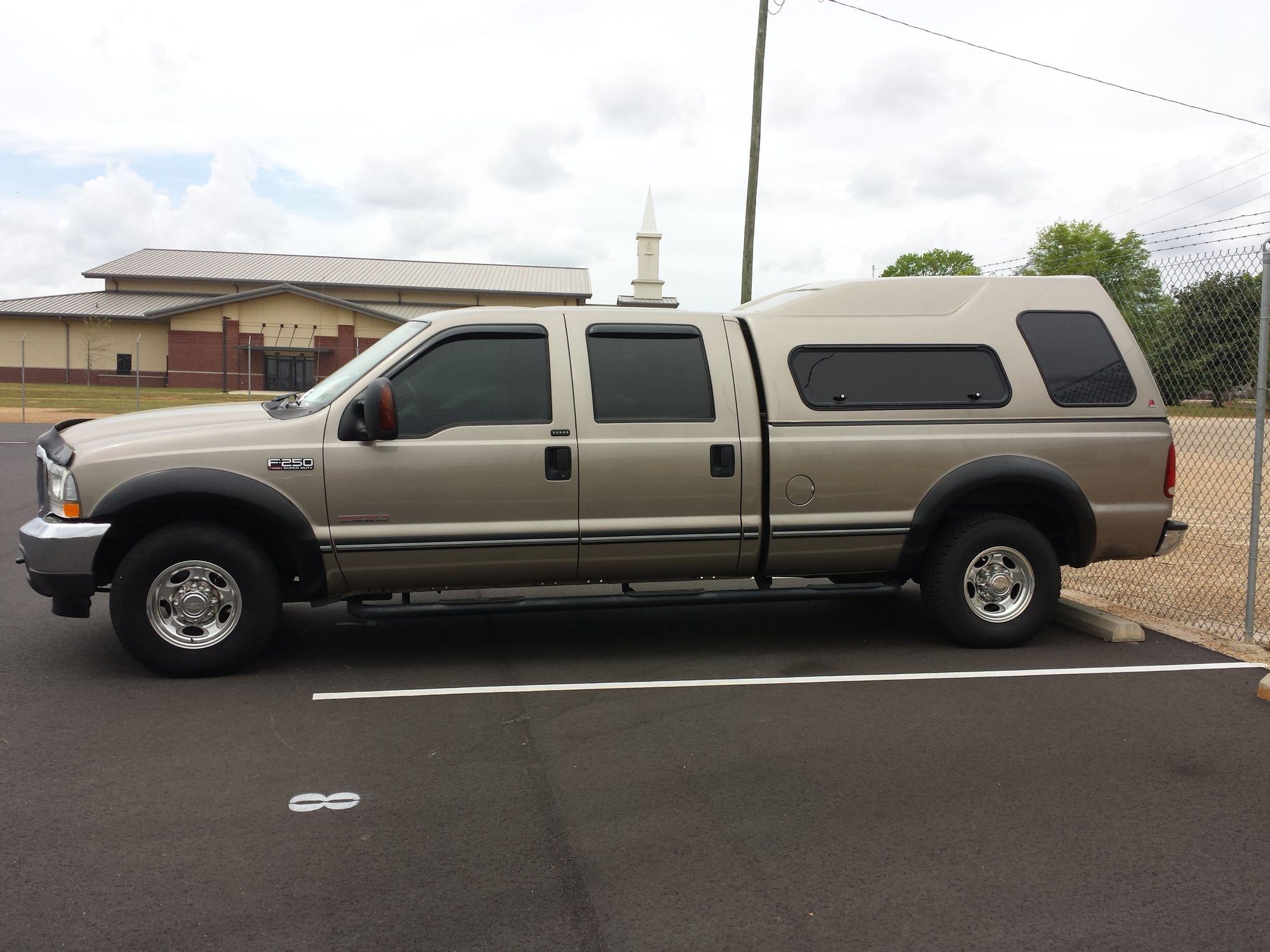

I recently looked at an 04 F250 Lar, 128K miles. The truck looked like new (garage kept) and the original owner says it is all original - that he's never had a problem / and only needed routine maintenance. And apparently lots of wax and loving.

When you are buying used you really look at the owner not the vehicle. In your case this truck would be worth it for certain. Garage kept and **** about detailing it. Then it is highly likely **** about maintenance and only using OEM materials (filters and such) which is key to a long lasting 6.0l.

I would echo what lupus seven is saying. Proper maintenance and addressing issues before they become big issues is the key. That truck sure looks nice, straight, not spa single dent or mark from what I can see and lots of tender loving care. If the original owner used synthetic oil, Ford filters and fuel conditioner on occasion that truck is well worth the Kelly blue book. My brothers 04 has over 400k kilometers, and he just broke down and HPO, EGR delete and injectors.
