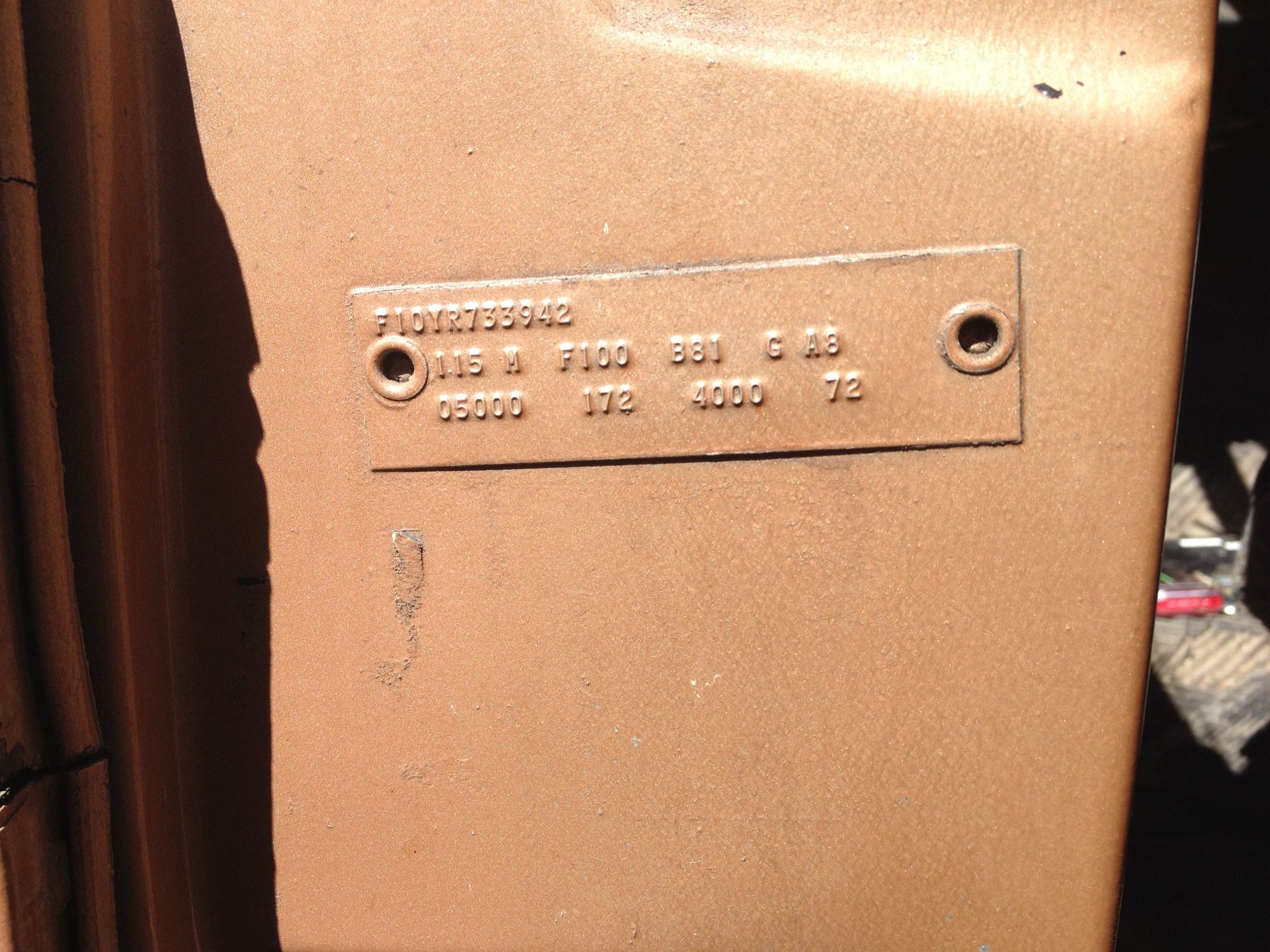

what do the codes mean
Old Apr 11, 2015 | 05:45 PM
ron safreno's Avatar
ron safreno
Joined: Apr 2015
Posts: 3
Old Apr 11, 2015 | 05:49 PM
NumberDummy's Avatar
NumberDummy
Ford Parts Specialist
Posts: 88,826
Likes: 787
From: Simi Valley, CA
Originally Posted by ron safreno
Welcome to FTE
F10 = F100 2WD
Y = 352 2V
R = San Jose CA Assembly Plant.
733942 = 1966, assembled August 1965.
115" Wheelbase.
COLOR: M = Wimbledon White.
MODEL: F100 2WD, 5,000 lbs. GVWR
BODY: B81: B = Medium Blue Crush Vinyl & Medium Blue Cody Pattern Woven Plastic / 81 = 81B Custom Cab.
TRANS: G = MX Cruise-O-Matic.
AXLE: A8 = Spicer/Dana 44 Rear Axle / 3.54-1 / Limited Slip / 3,300 lbs. Rear Axle Capacity.
MAX GVW LBS: 5,000 lbs. Gross Vehicle Weight Rating.
CERT NET HP: 172.
RPM: 4,000.
DSO: 72 = San Jose (NorCal) Ford District Sales Office, where the original selling dealer ordered the truck from.

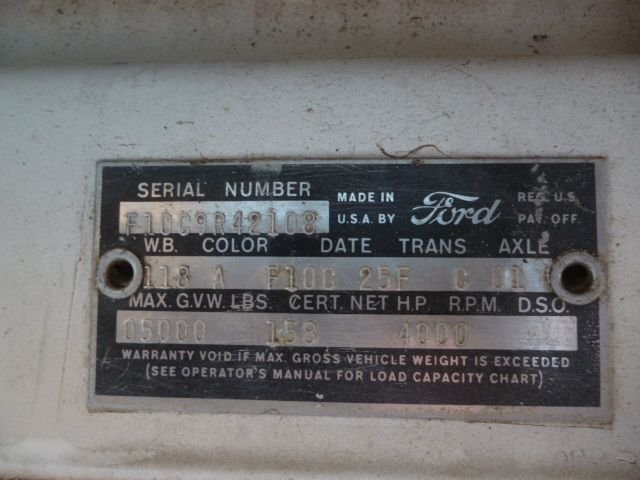

can you tell me what 'C' trans is ?
Old Apr 18, 2015 | 05:23 PM
NumberDummy
Posts: 88,826
Likes: 787
Welcome to FTE
C = 1957/61 = Ford-O-Matic 3 speed A/T
This is a 1959 F100 (5th digit of the VIN is a 9 / DATE: 25F = Assembled June [F] 25, 1959), so you should post further questions in the 1957/60 forum.
