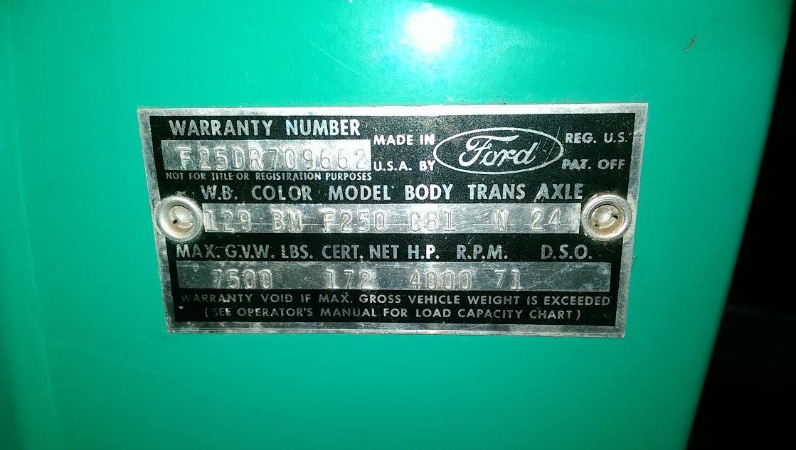

Decode please

F25 = F250 2WD
D = 352 2V
R = San Jose CA Assembly Plant.
709662 = 1965, assembled July 1965.
129" Wheelbase.
BM: B = Caribbean Turquoise / M = Wimbledon White.
F250 2WD, 7,500 lbs. GVWR
C81: C = Medium Green Crush Vinyl & Medium Green Ladder Pattern Woven Plastic / 81 = 81B Custom Cab.
N = New Process 435 4 Speed Manual Transmission.
24 = Dana 60 Rear Axle / 4.10-1 / No Limited Slip / 5,200 lbs. Rear Axle Capacity.
7,500 lbs. Gross Vehicle Weight Rating.
172 net HP @ 4,000 RPM
71 = Los Angeles (SoCal) Ford District Sales Office, where the original selling dealer ordered the truck from.

Thank you sir.
