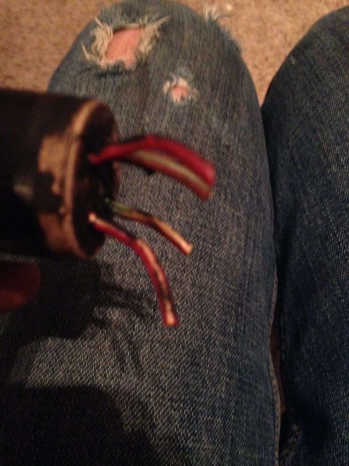

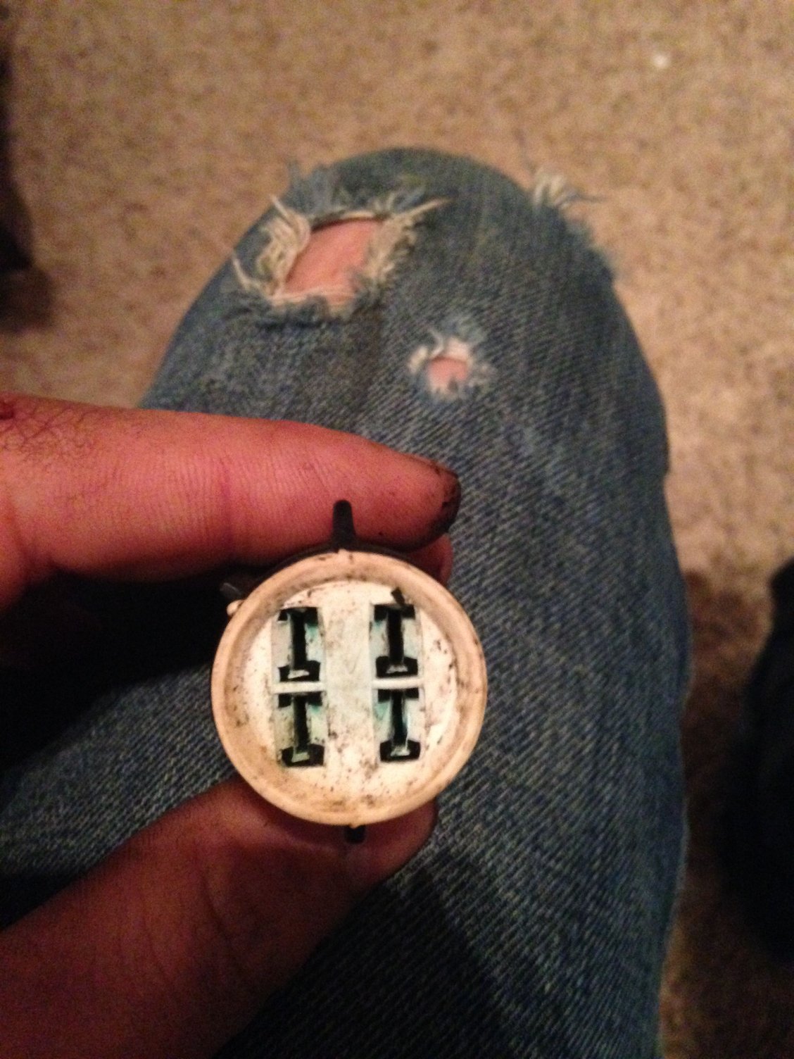

so I'm new to this but I am in some need of help with coding the wire on the water temp to the dash and the oil pressure to the dash the plug got broken so i am just trying to bypass the plug but don't know where the wires go
that is what I have if you have any pictures that i could try to code that would be great opr if you could just tell me what wire needs go where that would be even better

Your thread says ignition wiring but the post says water temp and oil pressure to the dash. Which is it? It is important because the wiring is in different pages in the book.

It the wiring harness for the distributor to the ignition module and with that there is the wires to the oil pressure and water temperature that gose into the main wiring harness

It matters a lot as ignition wiring is on Page 18 and the gauge wiring is on Page 58.
And, here's 58 with the gauge wiring, and 59 that shows the location of the connectors. You are probably holding C305, so you can see the wire colors as well as the location.

That worked thank you so much I truly appreciate it
