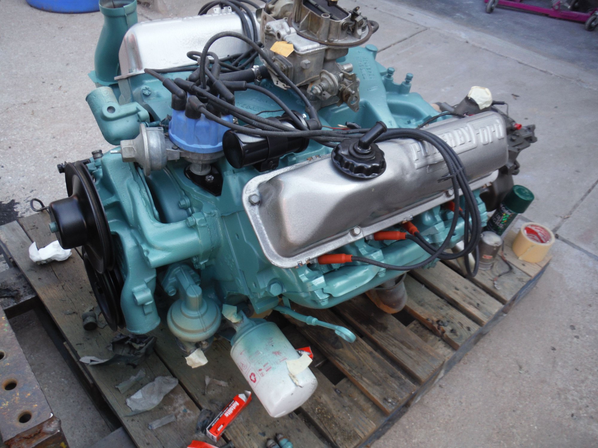

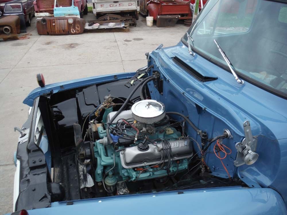

I have a 53 F-600 replaced the flathead & 4 spd with a FE eng 7 4 spd from a good running 72 F-100, all is going smooth and looking good, made a brk the park brake to still function. shortentened the drive shaft & re-balanced etc. now for the 2 pd rear end since I change over the complete 12 volt wiring harness from the 72 as well. I need to rewire the the 2 spd rear end electric motor. I have never had one of the off or apart? what should I know about them to make my conversion a success? All the original wires are bad shape what gauge should I run from the shift handle switch back? it looks as though i'll need to pull the electric motor and go inside to do it properly, also will i need to put in a voltage drop? since it is a 6 volt, with 12 volt coming it's way? any help would be appreciated.
