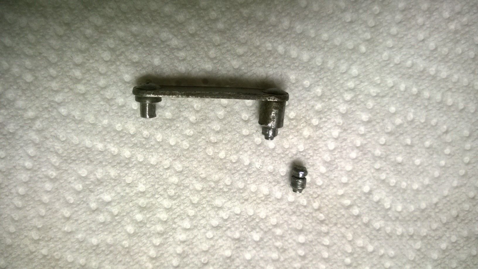

On disassembling my carburetor for a rebuild, the end broke off on a linkage piece that connects to the accelerator pump rod. Does anyone know of a source for carburetor linkage, please?

Photos attached to this post
Broken accelerator pump linkage
Rob, here is the part that I listed, the Ford carb and the Holley are the same carb.
