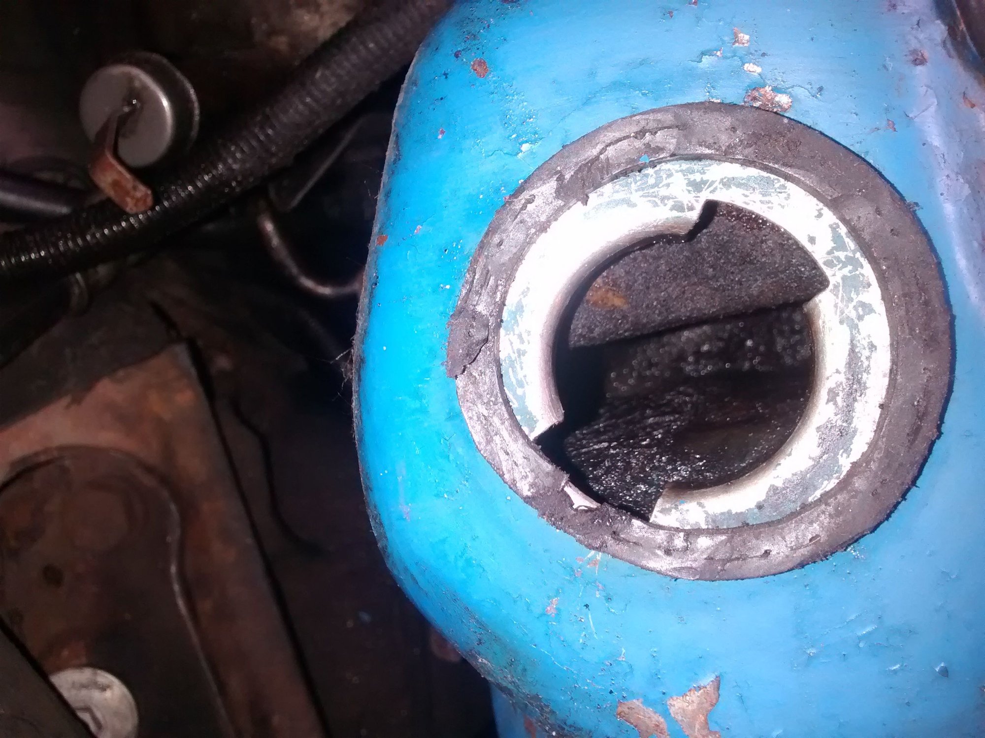

Checked my pcv valve. Moves freely, but i am able to blow a liitle bit air through it in the direction where it should close? Or is this supposed to be so? Should i replace it?
Heres a picture of the rubber sealing and the inside. If the rubber sealing leaks, could it affect engine power?
Old Apr 3, 2015 | 11:40 AM
Gary Lewis's Avatar
Gary Lewis
Joined: Jul 2010
Posts: 32,875
Likes: 48
From: Northeast, OK
Nice car. Should be in a movie.
I'd replace the PCV valve and the gasket.
