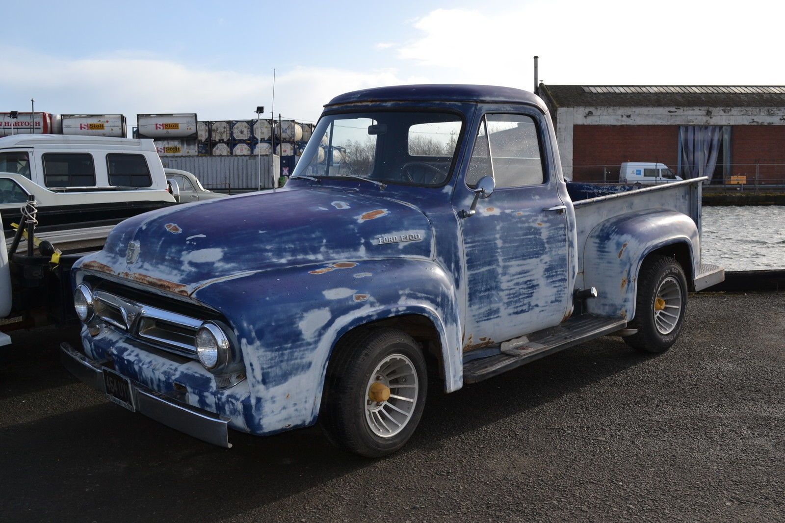

I have some pictures. She isnt much to look at right now. But that will quickly change.
Here is how she sits right now.
Will have the body in paint in the first two weeks. Will be removing the rear checker plate bumper, and front bumper. Welding up the front bumper holes, iv order'd an extended rear roll pan with recess from Mid-Fifty. Throwing paint on it then going from there.

That looks like a really nice truck. Let's hope it's really that nice when you get it. The shifter is an aftermarket conversion to floor shift. It's likely a universal Hurst or Mr. Gasket kit, but could be most anything. The shift pattern should be the typical H pattern with reverse left an up, but be careful as you never know what some people will do.
Most guys here convert to the 9"rear for better, more comfortable gear choices rather than strength. The stock Dana 44 is a pretty tough unit. The 3.92 gears will have the engine turning higher in the rpm range at freeway speeds without overdrive.

The engine has been updated, and likely the tranny along with it since the 53 had a flathead V8 originally. Sure it's a 272? It has the ram's horn exhaust manifolds more often found on the 312. One of our Aussie members is putting a Lexus IFS, IRS and V8 in his 56. I don't know what Ford sends over there or if any of their engines ended up in Jags when they owned it? Here's some info on rear axle ID and conversions: 1948 through 1960 Ford F-1 and F-100 Rear Axle (differential) Swaps - Ford Trucks I wouldn't be in a big hurry to make changes, the original suspension and axles, brakes etc are actually quite good once rebuilt. Here we call the exterior finish on your truck "patina" and is coveted by many they would leave it as is or put a coat of flat clear over it rather than paint it!
