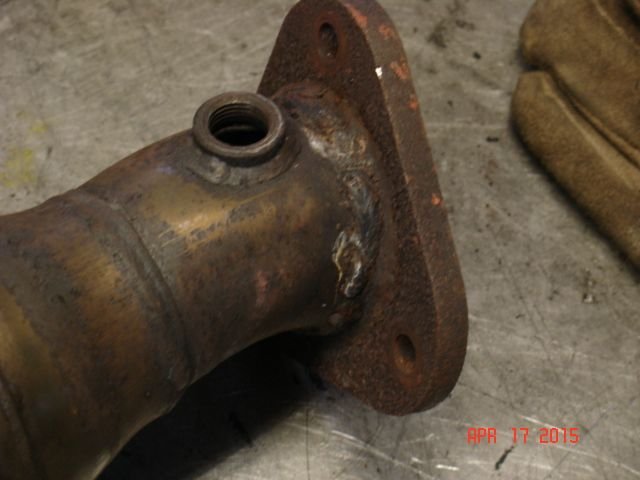

Can't weld rust so I threw the headers in the 'make new again' cabinet to see what I was workin with.
Even cleaned up its still bird poop. The saying persists that you can't polish a turd!

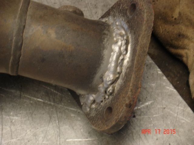

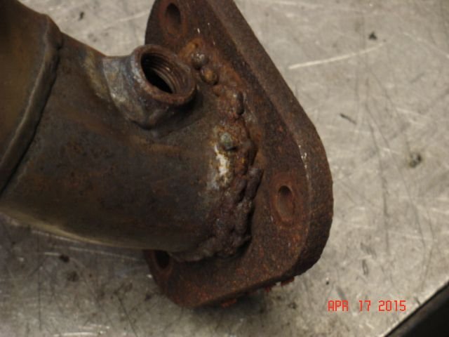

Sorry for crappy pictures. Ran over the worst of the bird poop, yes it still looks unpenetrated on the flange side of the weld but it is for sure all good.
Crack-b-gone, mine is the little tiny weld to the left if you can't tell. It is where the crack used to be. All the welds on the headers should look like this from the beginning.

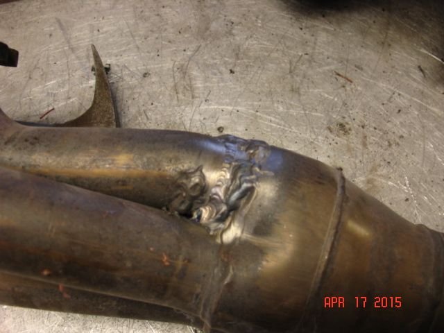

More poop-b-gone.
