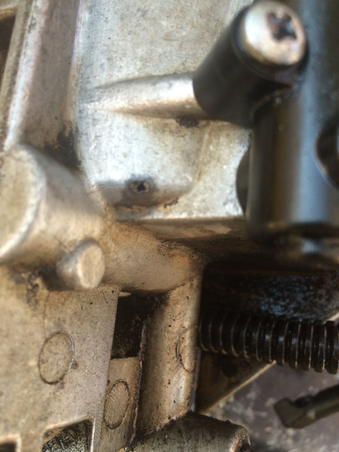

After looking with an inspection mirror I found a pinhole in the fuel bowl.Has anybody else ever had a problem like this.

I've heard of it before. Odds are you will have to replace the bowl

Tear it down and clean very well.many have covered the bottom with a layer of JB weld with good luck.

I'd give that a try. IIRC, the fuel bowl is only pressurized to 7 psi.
Otherwise convert to e-fuel, imo.
