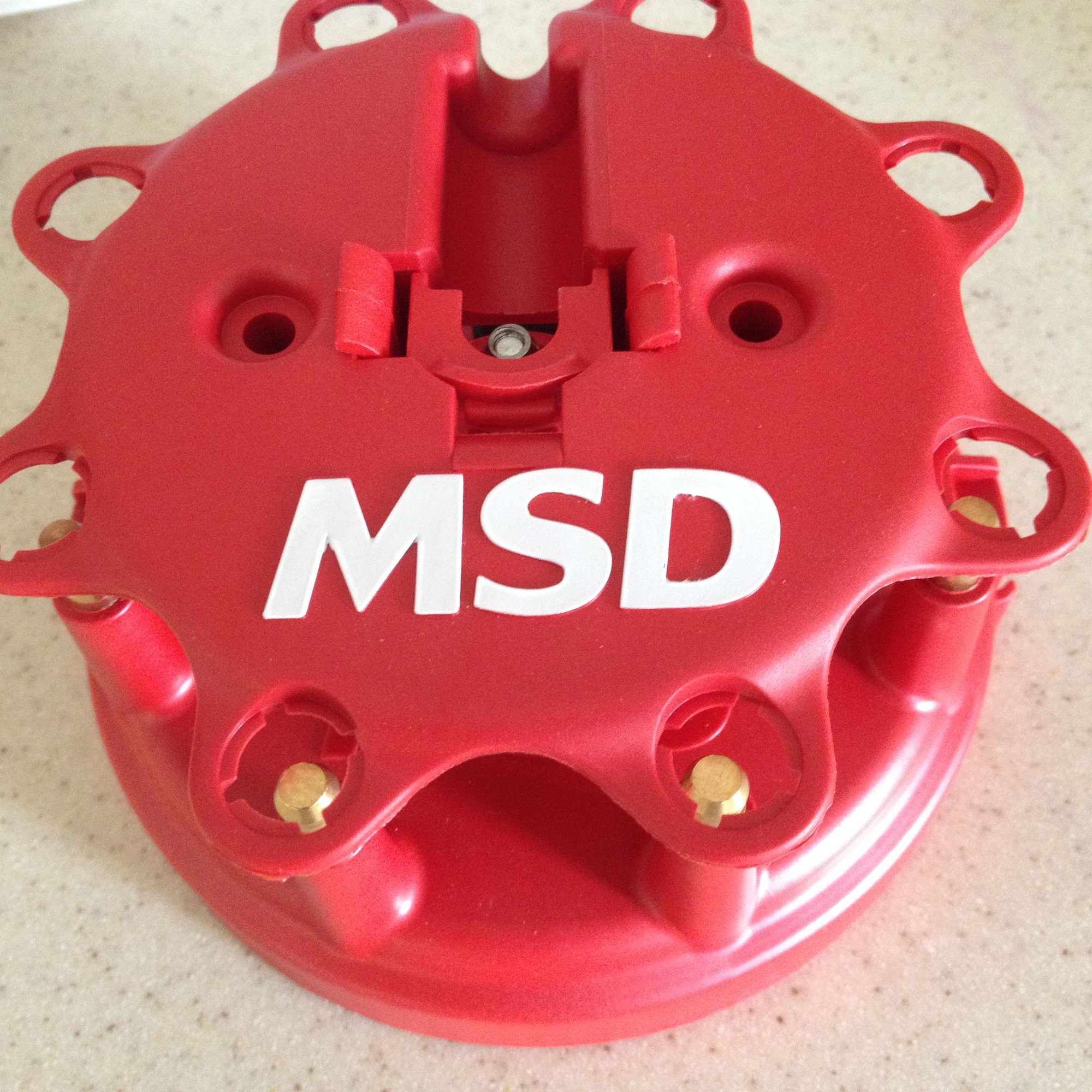

I had a brand new msd distributor cap laying around that I never used on my mustang with a 302W (I run a Performance Distributor, D.U.I., setup in my mustang). I went to change the plugs and cap on my f150 with a 351W. I decided to use the MSD cap since I already had it even tho I didn't think it was sufficient for my mustang. The problem I am having is that I think the cap was made @$$ backward. the MSD reads upside down and the tab to is on the side of the little black cap for the #1 plug.... Has anyone ever seen this? I knew there was a reason I didn't put it on my mustang, but what the heck? I've checked the firing order 3 times and moved the firing order around to three places around the top, and it won't start. I really think that this cap was manufactured backwards.... am I crazy?

A Picture is worth a thousand words.
Old Mar 30, 2015 | 12:43 PM
rugermack's Avatar
rugermack
Joined: Aug 2007
Posts: 1,852
From: Sonoita Hills, AZ

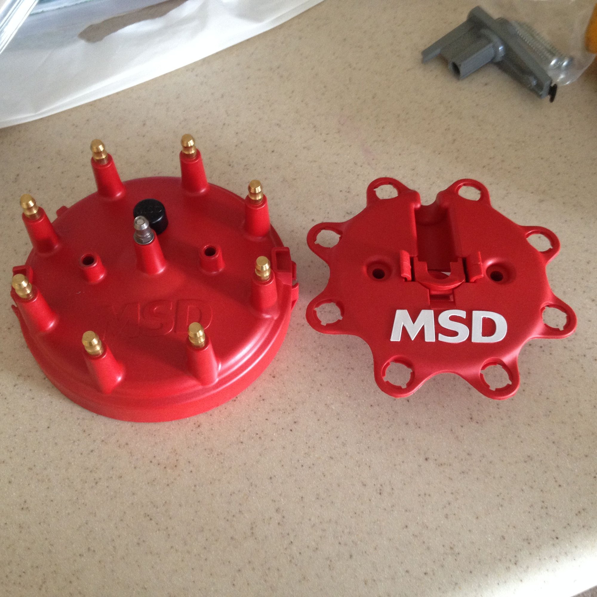

Here's the pics of mine.
