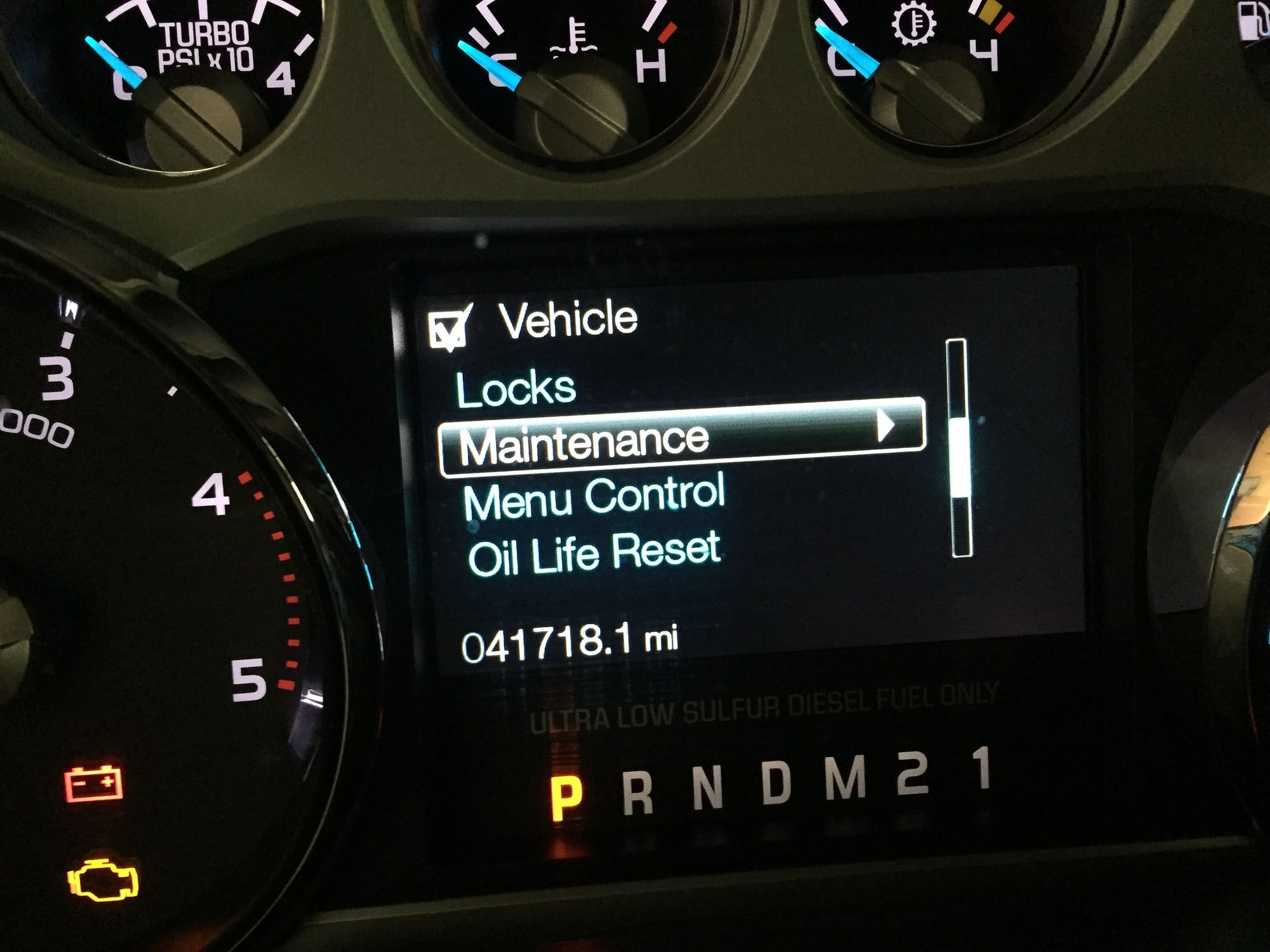

I read the owners manual refer me to the supplement, which refer me to the dealer

It's in there but your looking in the wrong spot. I had a hard time finding it too. Rather than trying to find it in the manual and telling you where to look, I'll make it even easier. Here's the steps to reset the check coolant additive indicator:
1) Start by going to "Settings" in your MFD.
2) Then "Vehicle"
3) Then "Maintenance"
4) Then "Coolant"
5) And lastly, "Hold OK if Coolant Additive Checked"
That's it. It's now reset and won't bother you again for a while...

Thank you very much I will go do it now.
