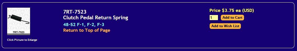

The clutch spring (short one) goes through the frame. The long spring goes to the brake pedal arm, which I believe is what you meant.
If you have your clutch adjusted correctly, there should not be any slop in the clutch return spring.

Thank You Sir! Looks like I may have the wrong spring after looking at your picture. I will order one.
I got mine from C&G.
Ford Parts Search - C&G Ford Parts
