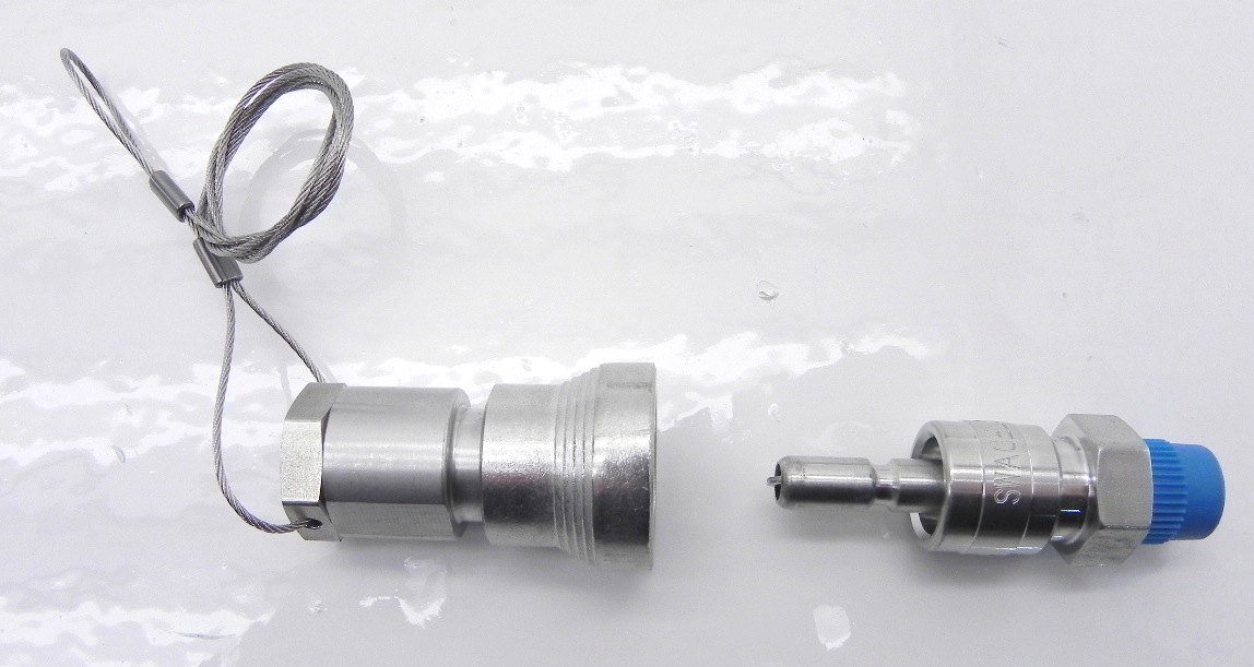

Yeah, we're talking about the same thing I guess ... quick connect terminology just made me think of something like this:
