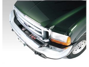

The hidden winch kit doesn't put the front bumper out that far. Honestly you can barely tell. If I wanted to keep the factory bumper, I'd definitely use the hidden winch setup. The bumper being spaced out helps clear larger tires anyway.
I don't like the way the transformer kit sticks out personally. I'm getting ready to install a fab fours winch bumper.

Some people do not like the fact that the hidden kit does away with the factory driving lights, but I've seen a few that just add lights. That is simple to do and takes that concern out of the equation.

I've seen the hidden mount in person and it was not impressed:
