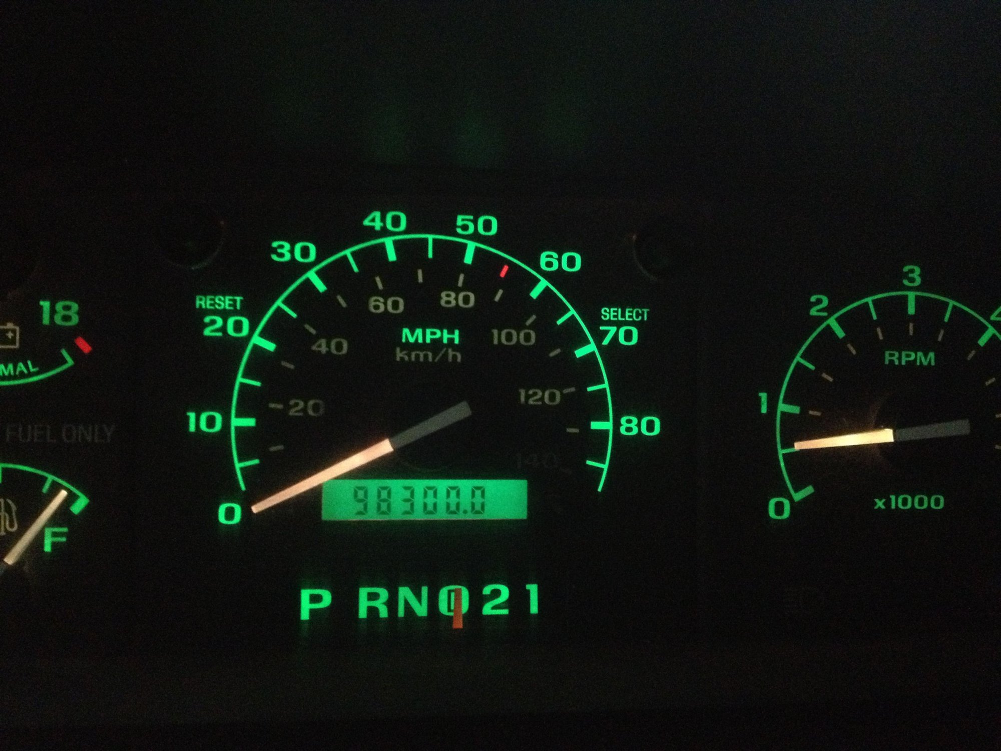

Hey guys, Got another question. This one has stumped me forever.
When my truck is cold (truck in sig) the idle is perfect. Once it warms up the idle drops pretty low and then starts to feel like a slight miss. Below is 2 pics, both in gear. The one in the day is when its cold. The one at night is once its warmed up. Ive cleaned everything (IAC, Throttle body, new air filter, plugs, wires, cap and rotor, fuel filter...
I checked the TPS voltage and it is 5V in and about .91 with key on engine off. Once its running it goes from .91 to really high and bouncing around erratically. Guessing that's not normal?

Then when warmed up idle is way lower and feels like it has a slight miss.
When first started and cold idles perfect. This is in gear.

Could be too lean at temp. Check your fuel pressure, O2, and coolant temp sensors.

Fuel pressure is good its just a lower idle. It idles great until about 10 mins of driving. It never stalls or feels like its going to it just idle lower and when it idles lower it feels like a slight miss. But cold idles great and smooth as a brand new truck.

Have you checked the pressure after it's warmed up? If the pressure is good warm, it could be O2 sensors. Any codes in memory?

When cold his idles around a 1000 -1200 for a min or 2. Mine when cold starts at 1,200 but drops to 750 or so within about 2-3 seconds. No high idle at all. Do 460's have a high idle?
