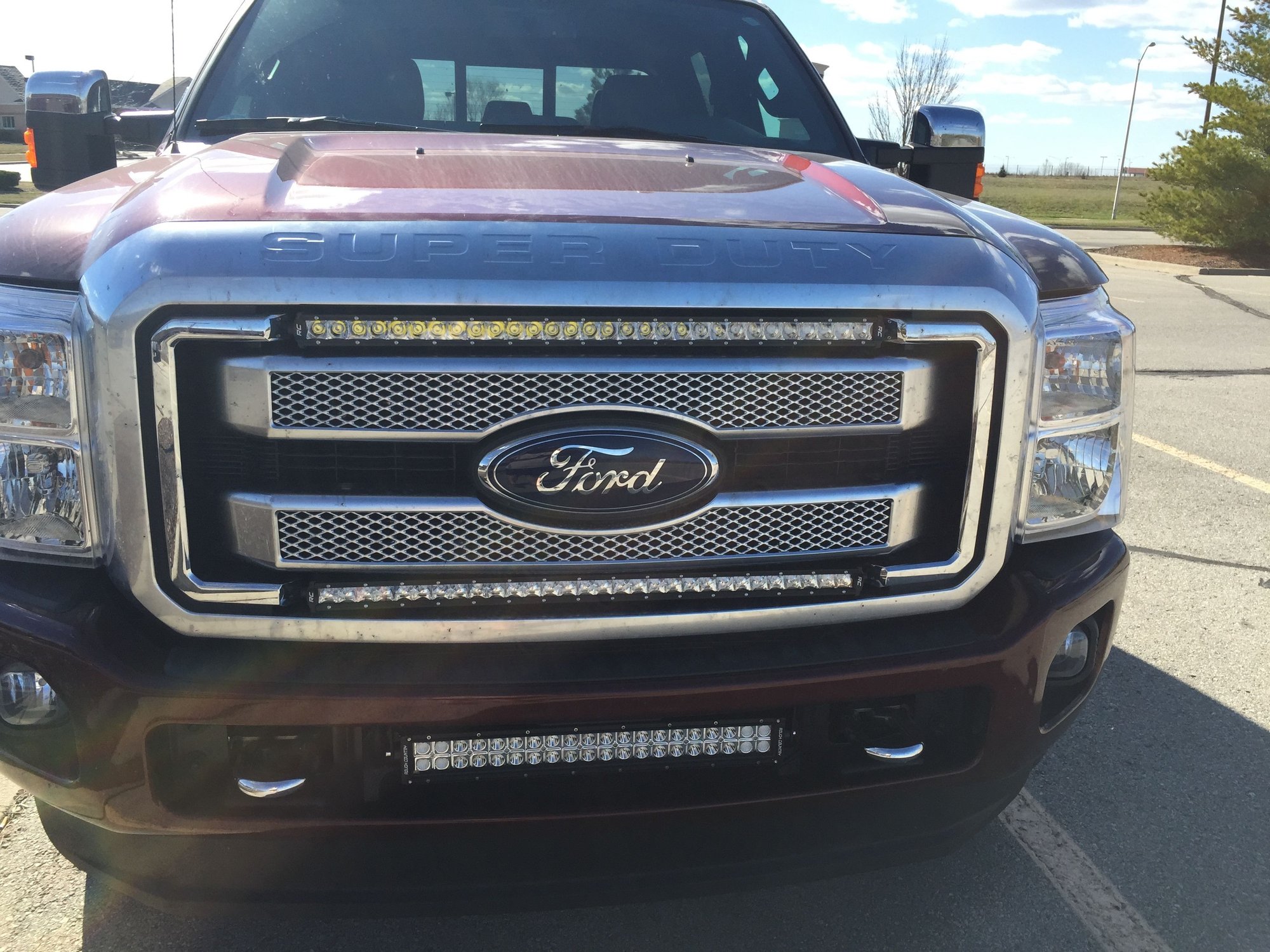

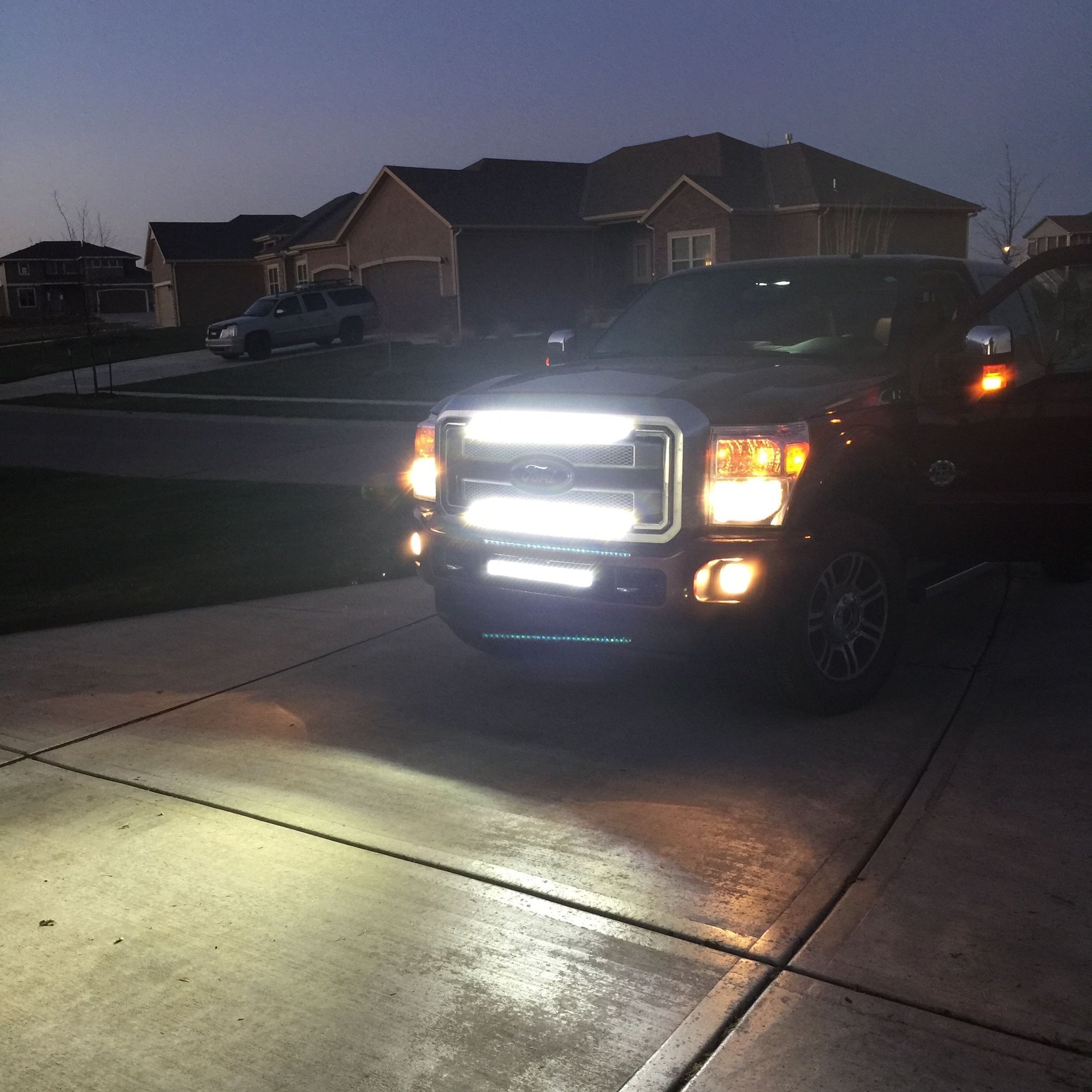

All bars are Rough Country, cheaper than Rigid, and still a three year bumper to bumper warranty. Double stack.
Here are some daytime pics...night time to come....after the sun goes down.
31,600 lumens in total
Hard to photograph...so bright.

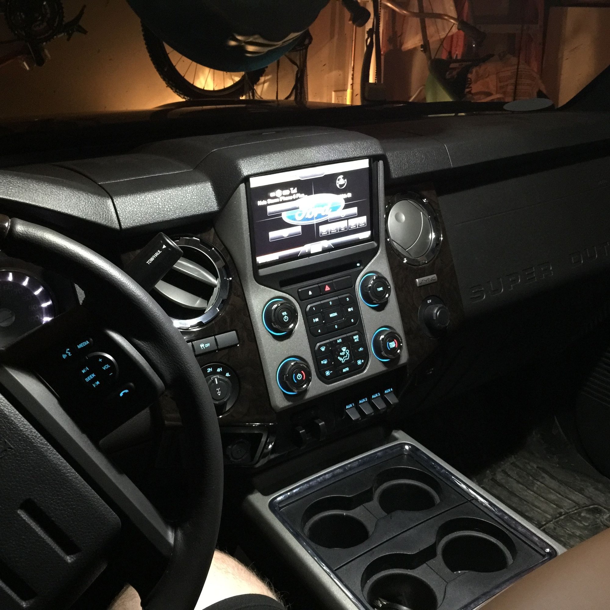

interior with LED lights.
I'll grab come more next weekend, at night...buzz out in a field a take some length and width shots. The do throw the light out a long way...not like the earlier generation LED bars that were tight...these shoot the beam.

Hey Tide, thanks for the compliment! Install was very easy...pop the grill out (screws on top, tops to need to access with a long standard screwdriver on the bottom...press down in the slots and it pops out...need to reach in behind the grill) then cut out a few of the plastic fins...few small holes in the plastic grill supports, and a mounting kit from Rough Country. The kit is literally made for these trucks. The light output is ridiculous...so so much brighter than headlights, and more than you'd EVER want to have on while driving into traffic. With a single bar on top, you'll light up an entire 50' oak tree from 100 yards back...top to bottom, and probably be able to count the leaves...with all of mine on, the leaves burn off...LOL In all seriousness, these bars are BRIGHT.
Also, I was hesitant initially, especially given the price vs. rigid. These bars have held up in amazing fashion. Carwashes, freezing temps, high humidity all of it. No clouding, scratching etc..like new. Really happy with them.

Very easy to install, absolutely. The directions are great as they are written specifically for our trucks...not a general bolt-on-to-anything scenario. I worked the two single stacks to #1, and the 20" double to #2. Everything is feeding directly off the battery, and the relays are screwed in to the compartment under the hood. For on/off I jumped on one of the cab pass-thru wires and hooked up under the dash, the bundle for the firewall and the up-fitter dead ends are right there...crimp, crimp, done.

Hey Brian, thanks for the note. An update to my interior lighting...the cheapo Amazon chinese made LED bulbs crapped out after a couple months, they started flickering intermittently. I've found some new ones on superbrightleds.com, but haven't ordered yet. The festoon bulbs in the rear are fine, its just the 168's for the map lights, and license plate. Could have to do with the voltage to these areas too i suppose...maybe its lower? Which should be perfect for an LED...I dunno (feel my frustration LOL). Anyway, when they work, it's awesome.
To remove the front may light cover, open your sunglasses holder on the roof, and press the two tabs on the back of the light fixture..either side of the front of the glasses drop-down, once that pops free with a little jiggling, the rest of the housing drops straight out. The metal/foil that is used for reflecting is garbage, and a pain in the a$$ to pack back in once you fiddle with the bulbs...assuming you have big hands and accidentally knock it out of alignment...GAME ON from there. Feels like that part gets crammed in there as fast as possible and the cover gets smashed on equally as fast at the Kentucky Truck Plant...poor soul who has to do that all day, like the seventh ring of hell fighting with that.
