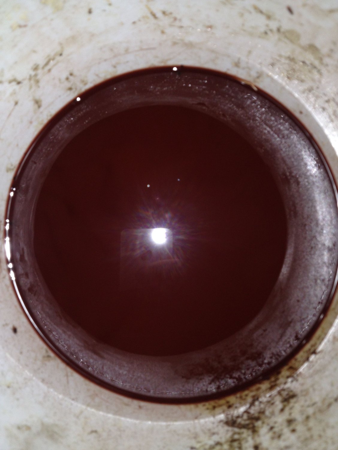

ok guys i got the t-case off, but while i was draining it the oil came out like brownish and it smelled like and old radiator........ also there is a piece of rubber that came out while i was draining the t-case.

this is how the t-case oil looked like when i drained it

That's just fine. There is no interval to replace the T-case lube, it doesn't go bad nearly as fast as it does in the transmission. Fill it up with fresh Mercon ATF and it'll last forever.
