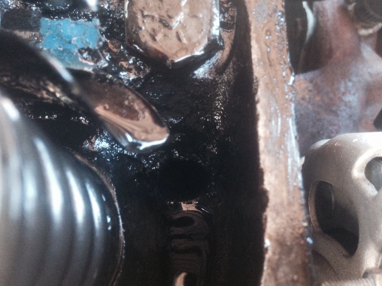

Just pulled the valve cover. Didn't see any noticeable floaties. Some oil pooled in the both the drainback "sumps", but no clogging. Reamed them out anyway with a super stiff ty wrap. Will be investing in a new gasket however.
Front drain back
Rear drain back
Sorry for the poor image quality. It was a blind shot.
Any more suggestions before I begin valve seal replacement 101?
Fail or not, this is pretty fun.
And thanks as always.
Mac

Yeah those aren't bad at all.
Oil still pools pretty well in there. You may have a bad seal. Or any one of ten other things it could be.
The most important thing is you're having fun.
