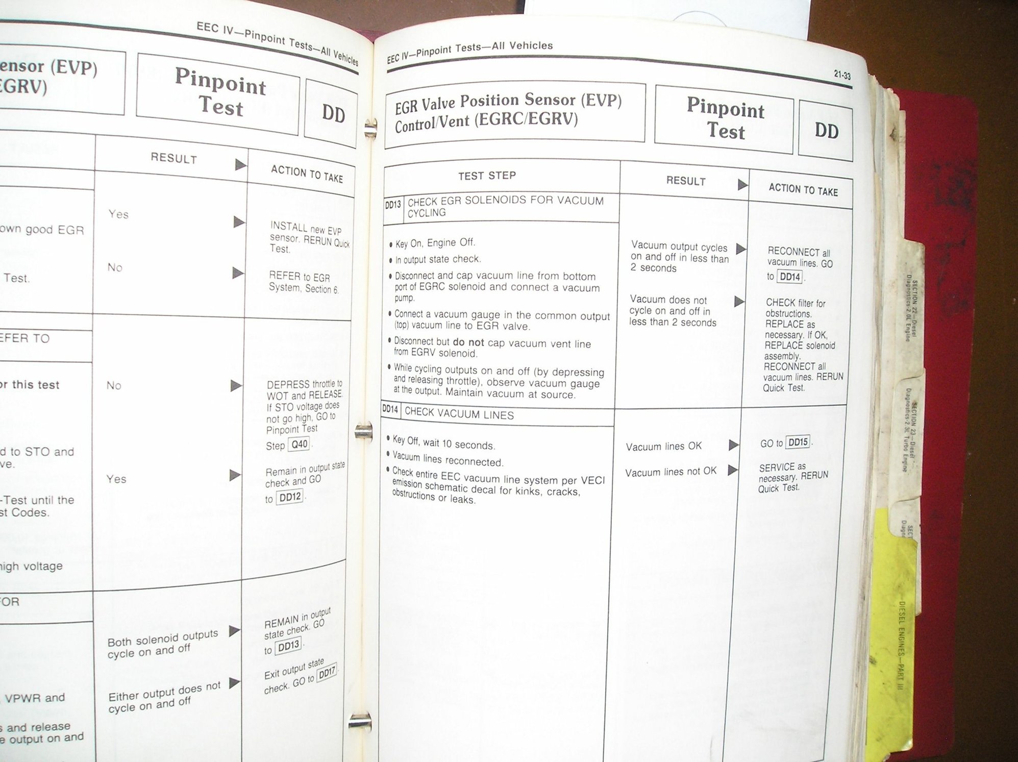

Yup, 41 = HE11 = EGO is reporting lean
34 = DD11 = EGR position sensor
Here is what the book says to do to further diagnose (hope you can read these):

Just tested my egr. It's got about 3200 ohms fully closed and about 230 ohms when fully opened. Haynes manual says around 5000 ohms closed and around 100 ohms fully open.

Last time I drove the truck with this EGR/EVP connected it stalled 1 time withing a 10km drive, and twice on the way back home.
Going to the bone yard today to see if I can find an EVP that tests closer to 5000 ohms fully closed and 100 ohms fully closed. For now, my old EVP is connected, but vacuum line is removed from the EGR and capped off.
Also: My reference voltage tested perfect at 5.02V!
