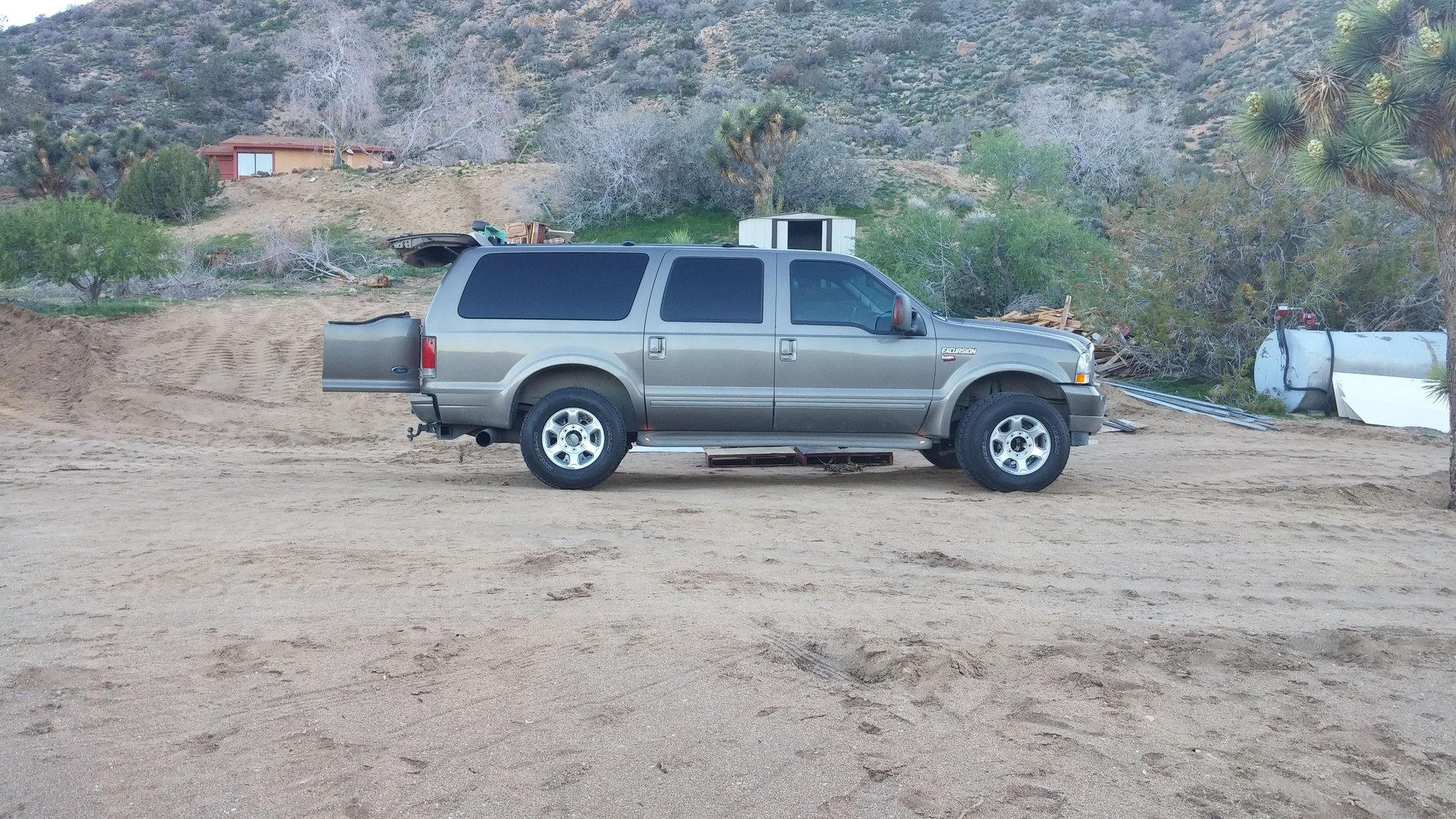

If I can squeeze it in the budget I want to put an 05 grille and lights in it to freshen it up. I am pumped on the new wheels I picked up today, I am trying to make it simple and clean looking. I don't want a crazy lift with huge tires, just a clean rig that I can rely on. I will post some pics I took today with my current look, and with the new tires setting next to it to give everyone an idea of what I am going. I appreciate any comments and suggestions.
My 04 ex
New wheels for my new axles

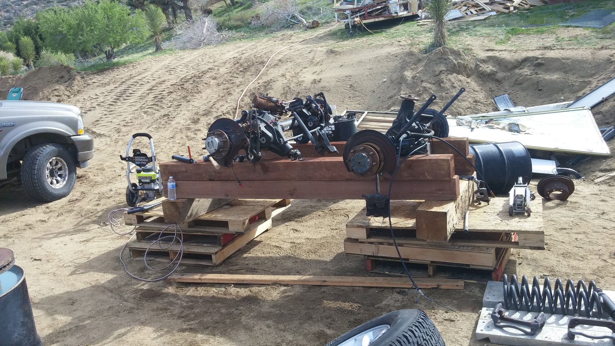

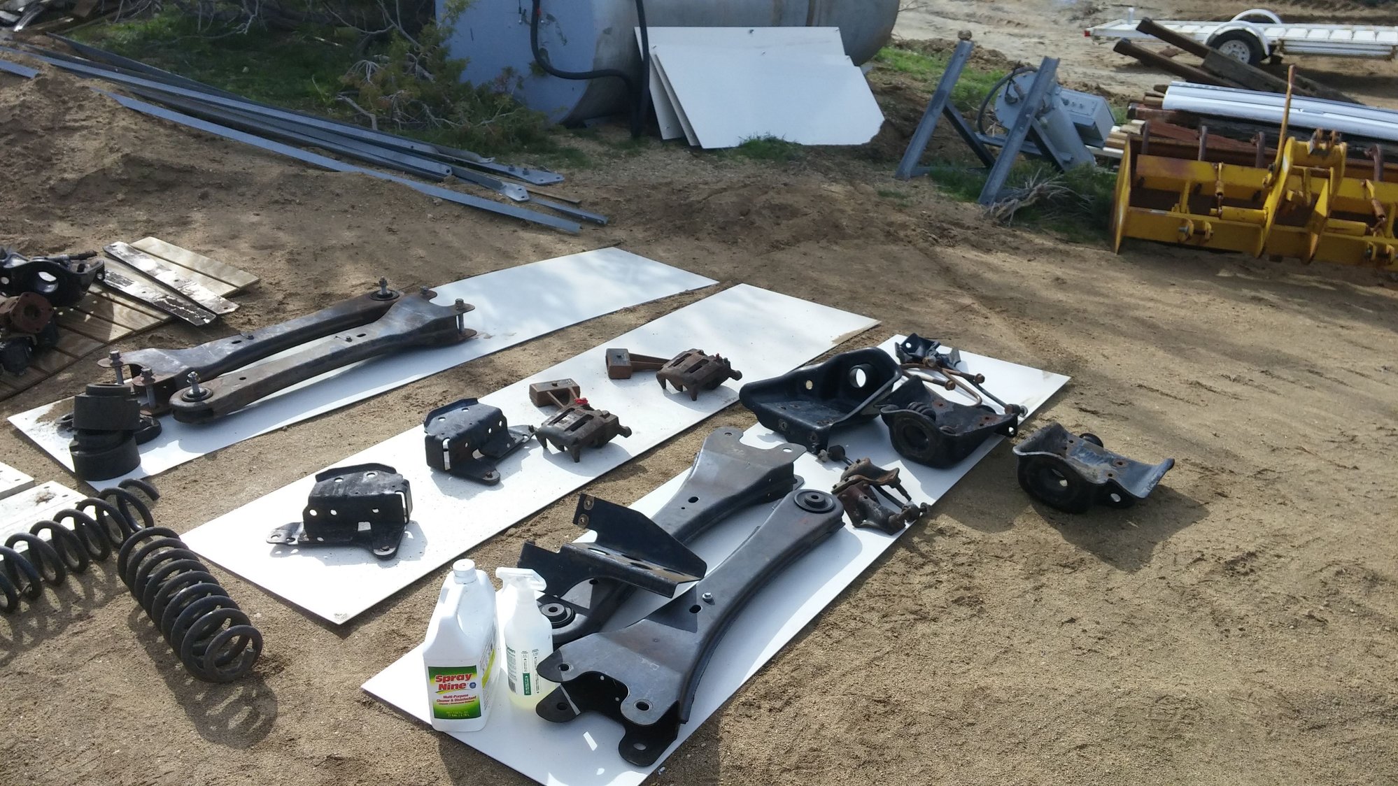

Thanks for the comments, the axles I bought have 56,000 miles on them and they were from Hawaii. There is a lot of mud that is very hard to get off. I pressure washed them and removed the rear brake rotors. Tomorrow I'm going to service the esof and change the diff oil and hopefully have time to paint them. I decided to use high temp flat black. I found out the rear axle is limited slip, I thought they were open diff. Big plus in my book. I will also inventory everything, I know I am missing some brake hardware.
Set them up on some scrap wood, thses things are very heavy, this allows me to roll them around a bit

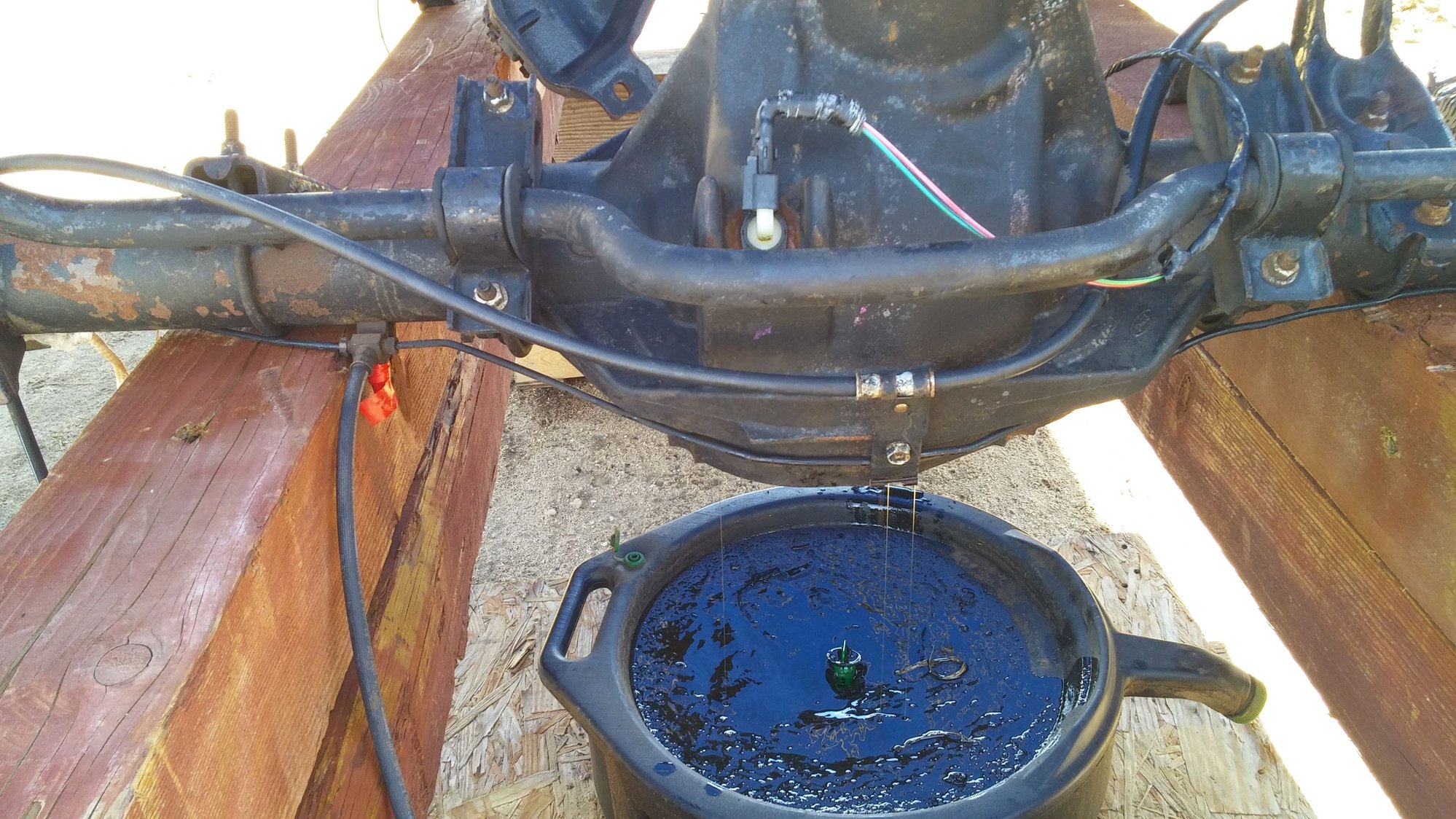

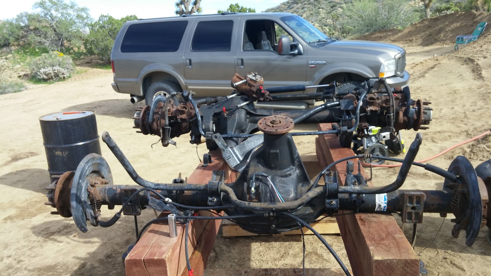

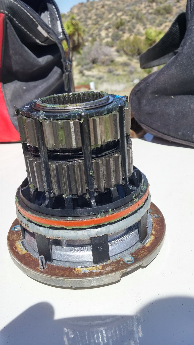

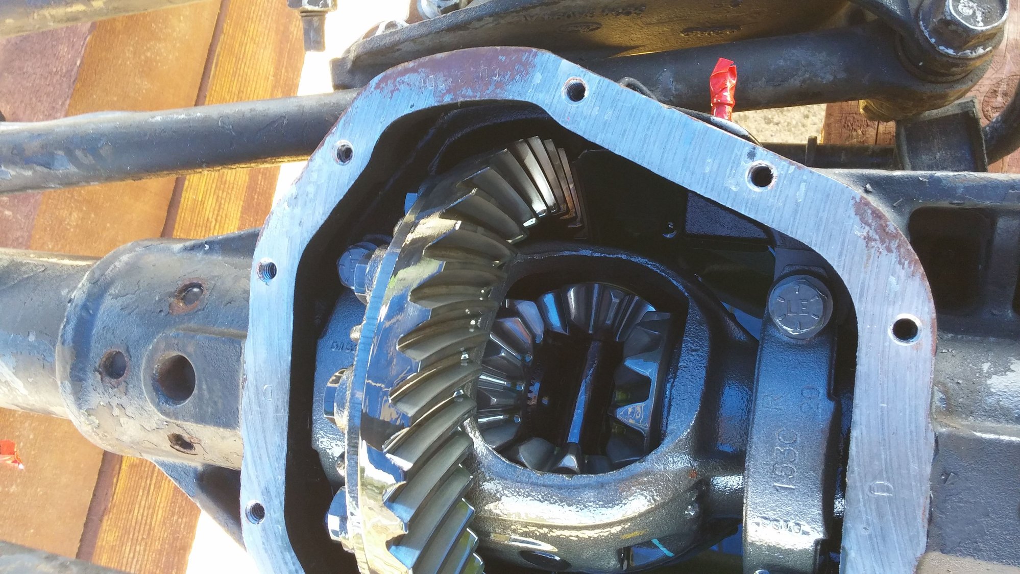

It took a lot more time messing with the axles today than I thought it would, making a make shift area to work in was time consuming. Progress for this weekend, I changed fluid in both axles, and pulled out the 4x hubs to inspect them. A little rust but everything looked great, here are pics of the progress.
Rear axle before
Oil was a little murky but no rust,cracks,chips in any of the teeth.
easiest diff oil change ever, I let it drain and started on the 4x4 hubs

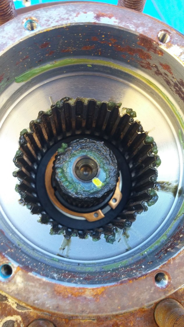

I was able to tap them lightly and they both slid out with minimal effort
driverside
surface rust along the mating surface
going to clean up with some emry cloth

Rear diff tags, 3L73!!
Front Diff, more surface rust between the cover and the housing. It came right off without a problem
new oil added, ready to put it back together
