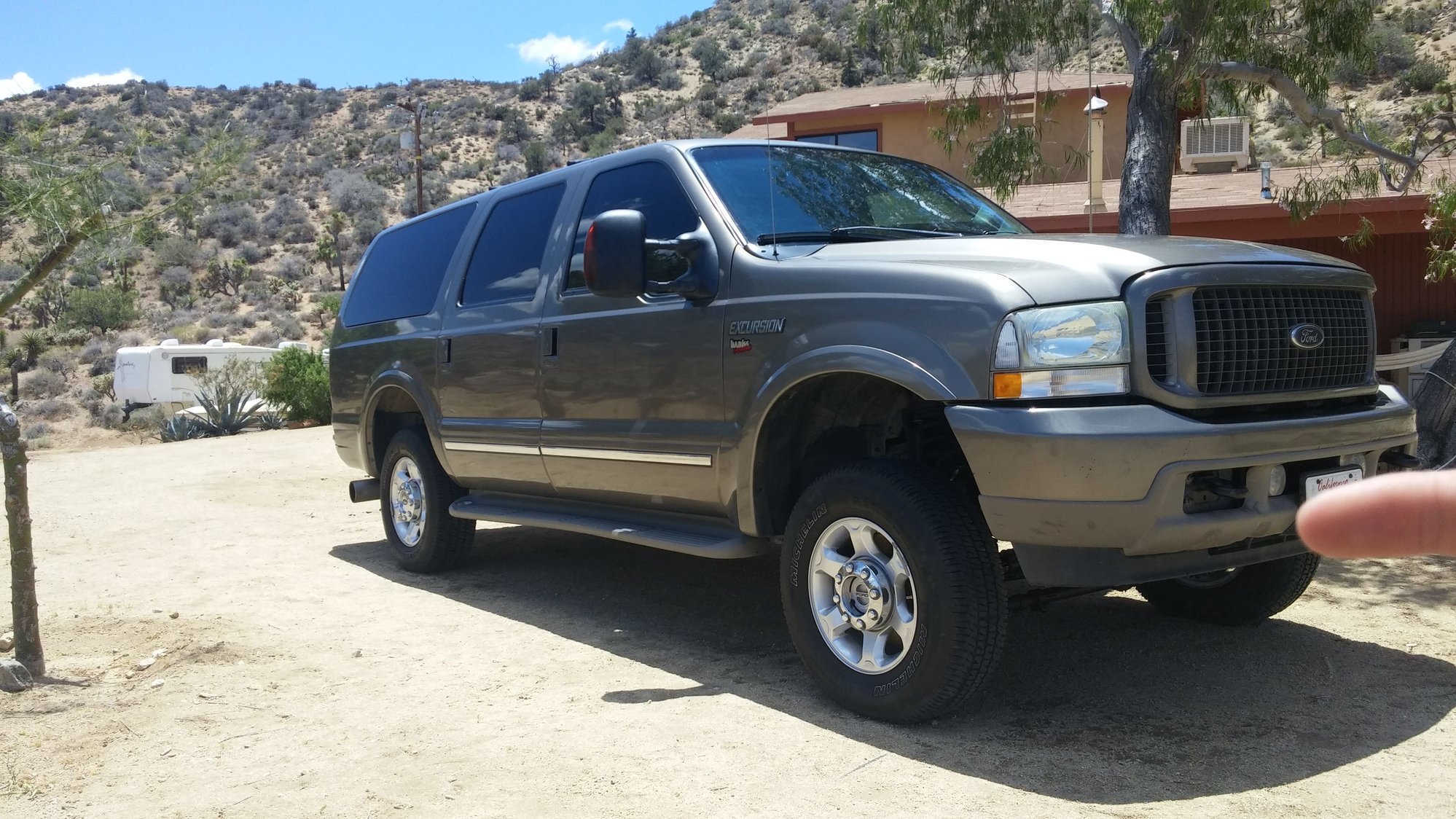

I've been busy, but I just got the excursion back from the guy who swapped the axles. The track bar proved to be a nightmare, the factory one was long, so I ordered an adjustable one and it was long. I had to take 2" off the adjustable track bar to get the front axle centered. Also my wheel choice didn't work out.... the backspacing tucks the wheels into the fenders, I definitely need bigger tires and a different offset to make it look ok. The rear didn't lift as much as I thought either so I need to get some stock coil isolators and ditch the leveling spacers. It turns amazingly sharp now and rides much better in the front. I have a few bugs to work out but so far I'm happy with it. On the hunt for wheels and tires again...
