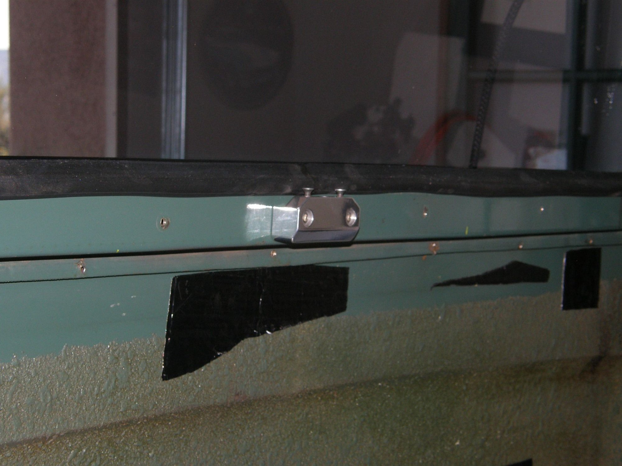

Here is the mount for mine. Sits in the bottom of the rear window, haven't installed the light yet.
Light will bolt to the top of the mount with the two little screws sticking up.

Rimrock.....great idea and l like all ideas for low cost and using what is available to us. Maybe a top flat mount on the back window with an LED that changes from red to white depending on the braking or backing up mode??? Another idea is cutting to length a rear above the bumper LED mounted in the cab rear window??? All the posts to this thread are nice!
