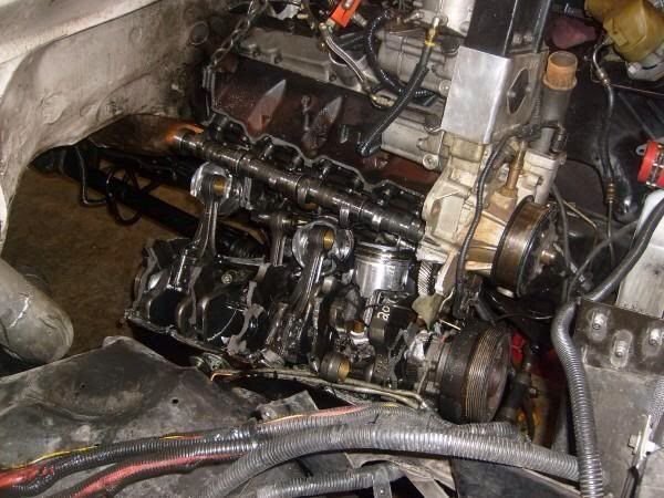

Bryan Thompson son(the owner of BTS) did this on stock SD fuel system and and 95+ psi of boost. They pulled then engine in three pieces.
